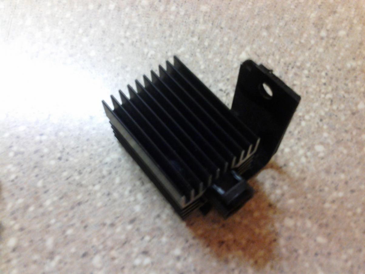

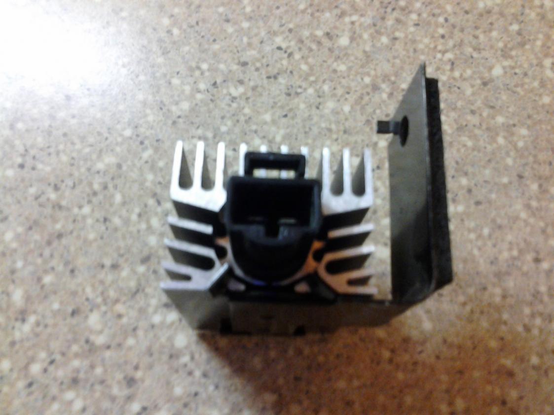

Ok found the problem just do not know what it is called, part# or if I can get it other then the dealer. It is under the dash metal finned box looks like it might be a diode. It ha 2 wire that go to it. Can anyone help? I am attaching a photo. Thanks
