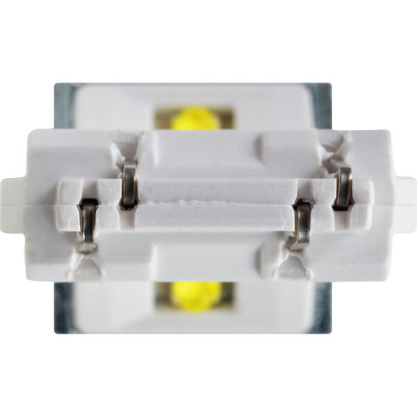

I was just curious, so I took a look back at when I did my DRL conversion to LED.
Sylvania seems to have designed the contacts on their bulbs in a way that ensures the contacts are in the right spot no matter which way the bulb goes in, to make it non-polarity...
In the pic, you can see the top row of contacts is offset to the right. The left contact is inside the position of the one below it and the right contact is outside the position of the one below it. If flipped over, everything is exactly the same.
I put Sylvania LED in my DRLs and had no issue and did not have to flip them around to make them work. Plug and play. No polarity issue when I did it.
If you flip this one, I bet it does not work.
