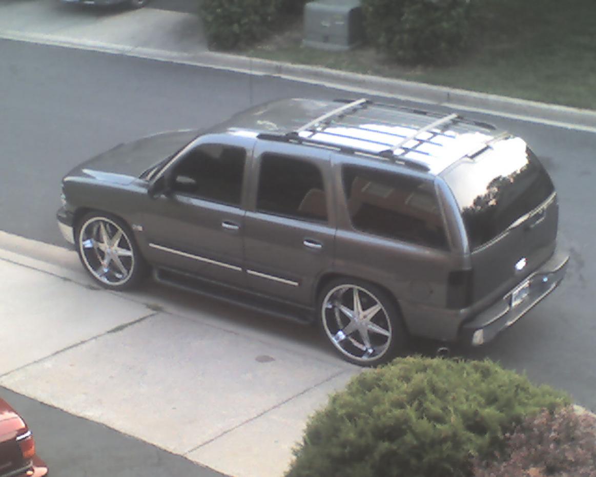

Shocks will drop it another inch or inch and half, coils should settle 3/8" to 1/2" you can always pull the isolators but it would sit past a 4" drop. Rear should sit the same as mine in the above pic, don't worry it will look dope :cheers:
