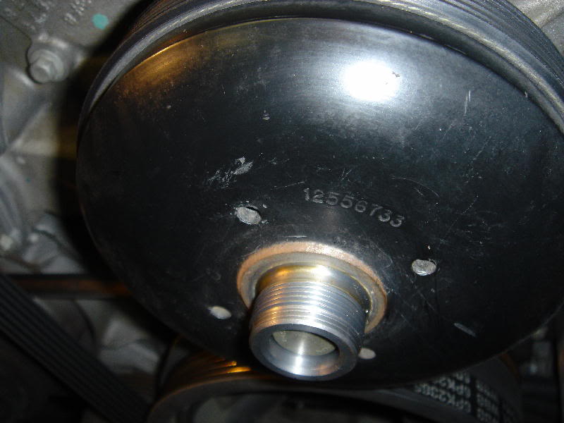

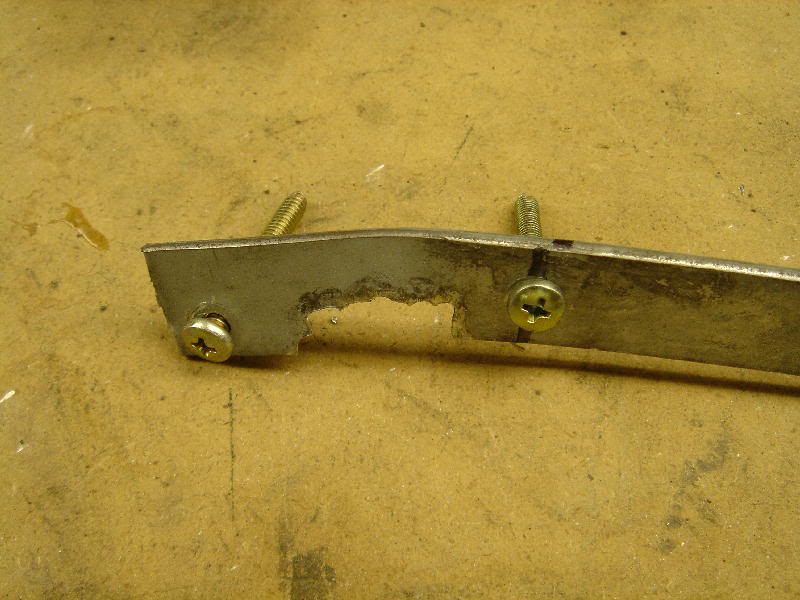

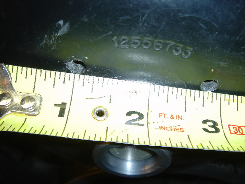

Do you 00-02 guys have the 4 holes in the pulley? I just modified a piece of scrap metal I had laying around to hold the pulley in place, and I used a big pipe wrench to turn the fan nut.
The nut came loose on the first try, and the best part was that I didn't have to spend $$$ on renting/buying a tool I would probably never use again.
