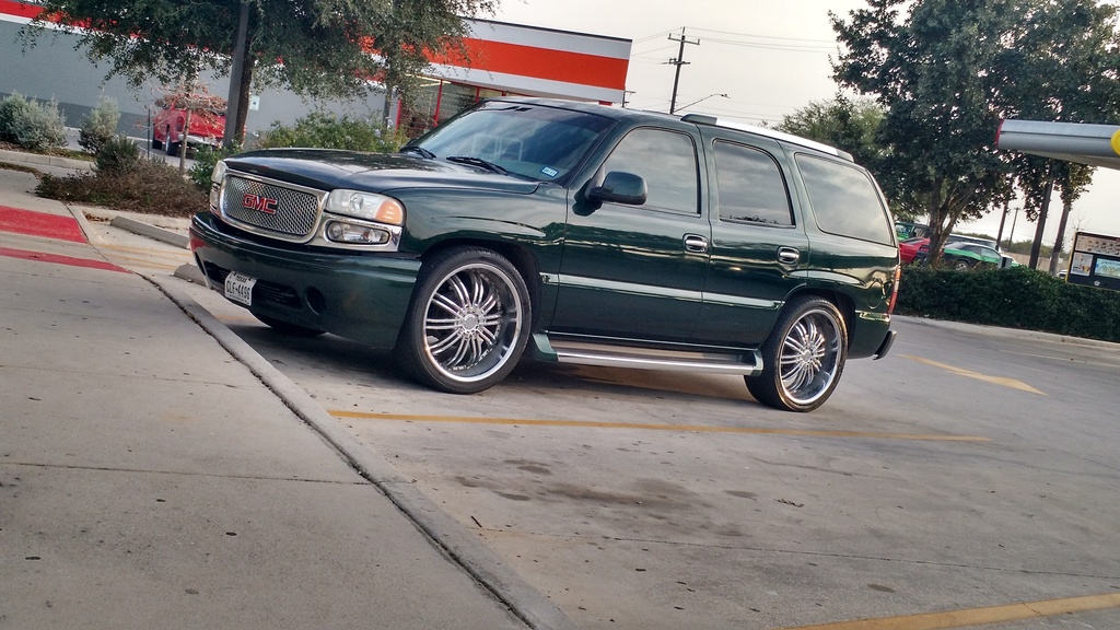

I am currently dropped 3/4 on keys and springs with 24's. I am really looking to clear at least a 33x12.50R20 with a -24 backspacing. at least thats the plan. I understand I may need a rear spacer as the front track width is increased 1.75" per side with the spindles. obviously each kit will require extras pending the configuration I buy, but if I did the 3" spindle I would only crank the keys 1" for the extra lift, If I do 4" spindles then I would still probably run 1" lift on keys. I am also looking at the Z71 springs and the extension for the rear parking brake cable. I am looking at a local sale of 35" Terra Grapplers with Moto Metal wheels that have less than 8k miles on them for $1300, I was originally set on 33's since I have 3.73's and wouldn't have to regear asap, if I go 35's I would regear within weeks.
I am alos looking at a Nelson Performance tune and 4.56 gears.
