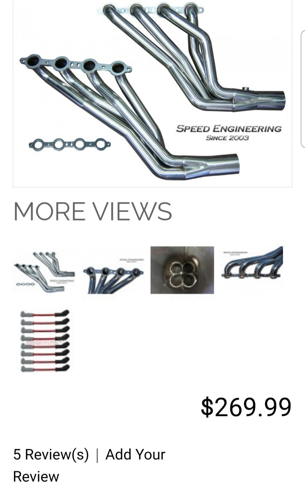

I was just going by the pic of the headers themselves.View attachment 263955
I wouldn't be surprised if many of the budget header companies copied each other. Hell, they'd just have to walk over to the next Chinese sweat shop and snap a few pics for ideas.

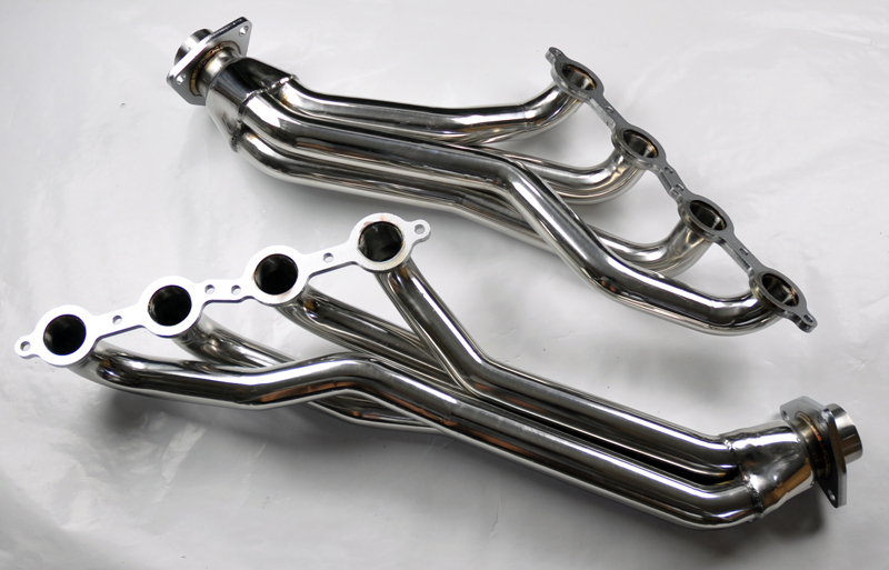

Now that I'm curious, I snagged a pic off that eBay link for comparison:
20201203_205952-jpg.263955
The SE primaries appear to be more of an equal-length design. The eBay ones have the #1 and #2 primaries turning horizontal before turning downward. Those cylinders are the longest distance from the headers, yet they're made to be even longer paths. The eBay ones also have a short, rather abrupt collector with a funky step-down in it. SE's collectors are longer and more gradual and have a smooth transition to the 3" outlet size. They also have "merge spikes" to further smooth the transition. I don't know if these merge spikes make any notable increase in performance, but it's a difference nonetheless.
Now I kinda wanna compare these eBay ones to the other cheap-o headers. lol
