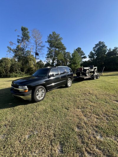

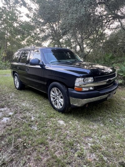

So I’ve been needing tires for awhile and just really didn’t want to buy new ones because I’m a cheap phuck. A deal popped up on something I’ve wanted since I was probably 5 and part of the deal was to trade my black AT4 20s. Luckily I have my buddies still blown up 408 Denali in my yard so I stole his maybe 2021 Highcountry 20s?
I think they look pretty good, also here’s what I traded for. I put cash on top as well of course.

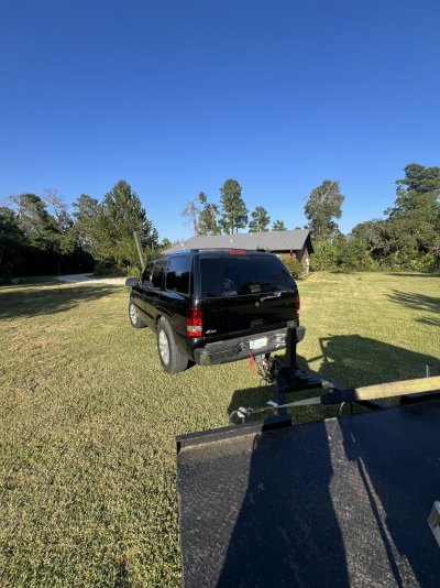

Also those got new tails to better match the new wheels, I’m really digging the wheels and tires, quieter, and I like the look. Never was a fan of a blackout look, but those black wheels were the best deal at the time.
