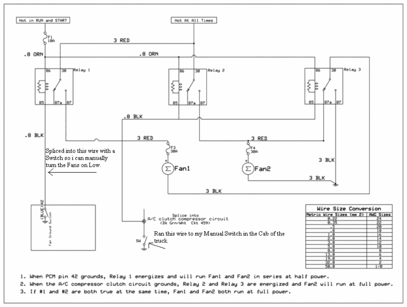

Each fan on high draws just below 30 amps, mine measured around 27-28 amps. Not sure what they draw on at low but would guess 15 or less. If I remember correctly both are never on high together might be wrong but going off memory without looking at the schematic. I think its one fan on high for engine temp high and one fan on high when running AC. But when both are true its low for both fans. IMO its a great mod since 05+ all have them. I will try to post the schematic to show how there wired up

Jason- I have not installed the E-fans. Still deciding on if they will help or not on the 8.1 due to the larger cooling needs it requires.
Raiderron- The stock fan keeps it cool even when towing so I don't necessarily need an extra fan.
Does anyone know if the 05+ 8.1 came with E-fans? I know the 5.3s did, but can't seem to find an answer to that online.
If they did then I will try and find the stock setup and install it instead of aftermarket fans.
