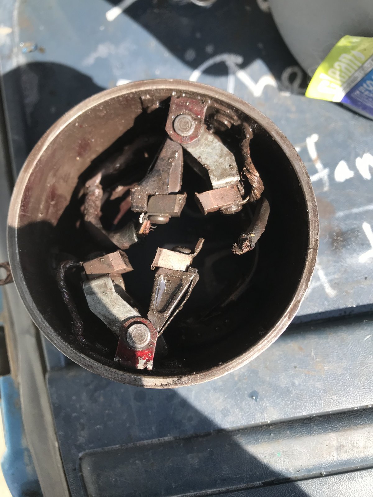

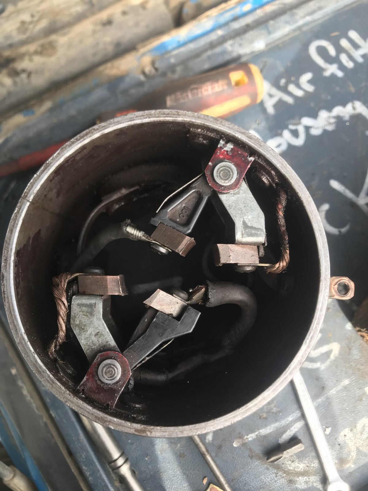

Example - every 3rd time I went to go start the truck, nothing but a running boost would get it going .
GM dealer couldn’t even explain it.
someone said it was my alternator
the other half said it was the starter .
the guy I talked to about my starter, said it was pointless to “rebuild“ it and sauder? < not sure on the spelling sorry. But
I fixed it and it sings like a canary...
even took it for the same drive, same heat and everything. ‍♀️
