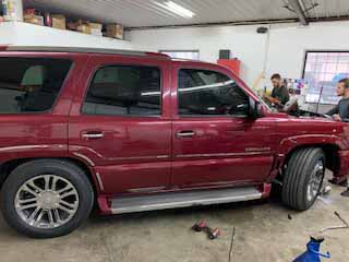

Just heard from the builder they are swapping the stock 6.0L in my 06 Escalade tomorrow! I'll be headed up that way on Tuesday and will post some photos then. This is what we are replacing it with, along with TBSS intake and fuel injectors and Summit Racing shortie headers.

I'll do what I can for photos. It's frustrating having the build done 5 hours away. The builder is really busy. He gives me updates by text message pretty regular, but forgets to take photos. I'll be there most of next week and plan to take plenty of photos.
