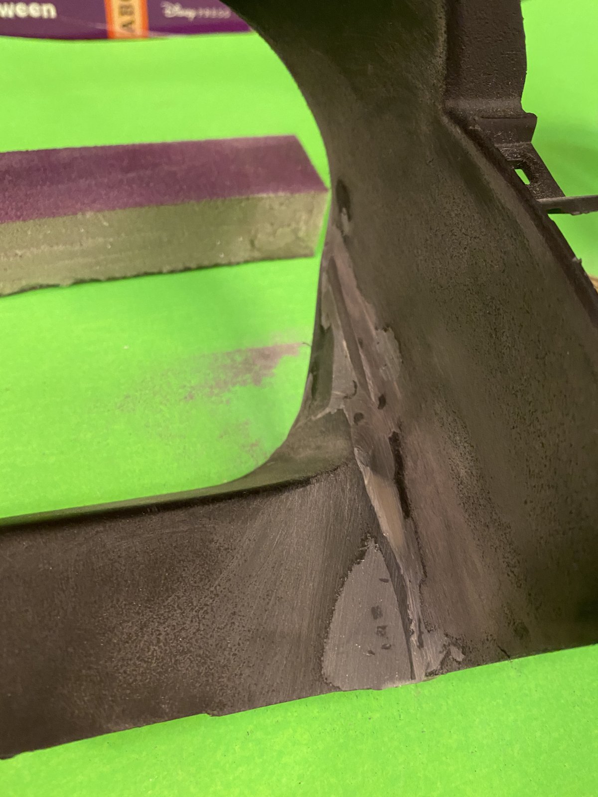

Finished good enough for me. Gotta find some SEM paint tomorrow. I might go over the entire bezel with 220 just to make it all even

View attachment 270791 View attachment 270792
You’re sure you don’t wanna do another coat of fill and a bit more sanding? All that’s going to show no matter how many coats of paint you put on. What did you use to bond the parts together? I went with Fusor epoxy and filler but I already had the gun from doing Harley fairings. The damn gun was like $50.
thats sanded with 220. The pictures make it seem like it has high and low spots but nothing can be felt with the finger. I’m going to hit it with a coat of high build primer in the morning and go over it lightly one more time with 220 or maybe a little higher grit

I tried a bunch of different epoxies which all didn’t want to stick to the plastic. JB Weld actually ended up being the only one that gave me zero problems with bonding
