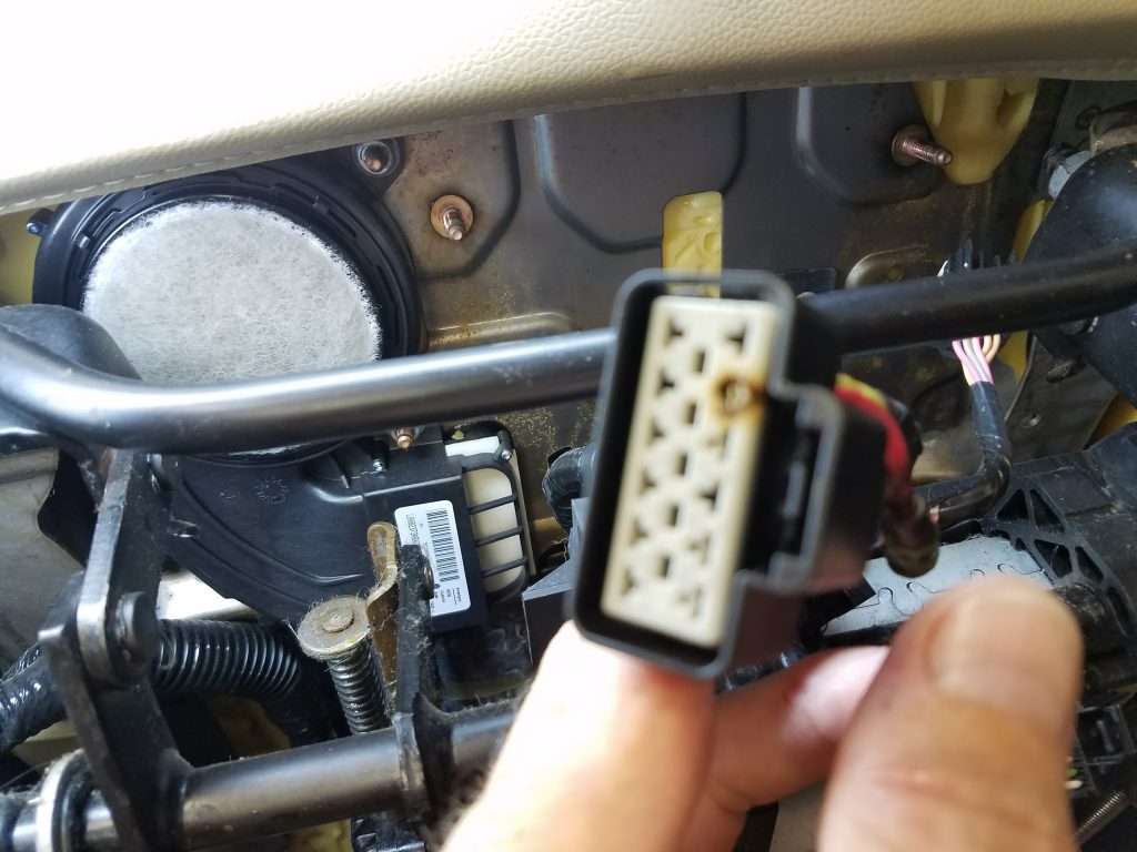

So I traced my seat heater and cooler issue down and found this burned pin.
I found this totally legit earlier repair on the wiring (tape removed for clarity.)
Here's the burnt pin on the connector. Sorry about the focus but there's my seat cooling fan.

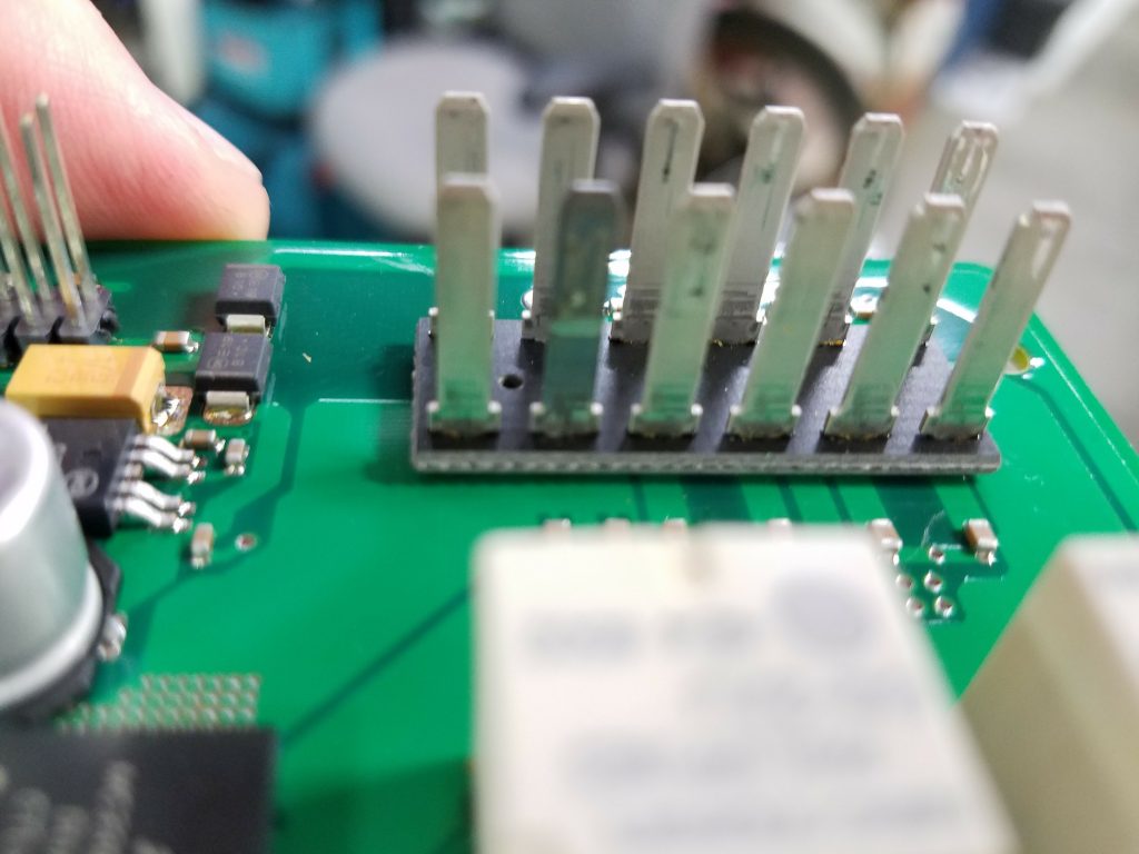

And the pin on the circuit board where this connects.
Someone posted that the connector next to this pin is connected to it on the circuit board so he added a jumper to use two pins. My connector doesn't have the contacts in the unused hole so I'm going to add a wire around the pin.
