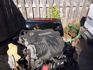

image.jpg image.jpg image.jpg And as you can see I got the caddy rear glass in the back ground and the corners also. I have some work ahead of me now!!!! I also took the hydro boost for the 2000 white one.
