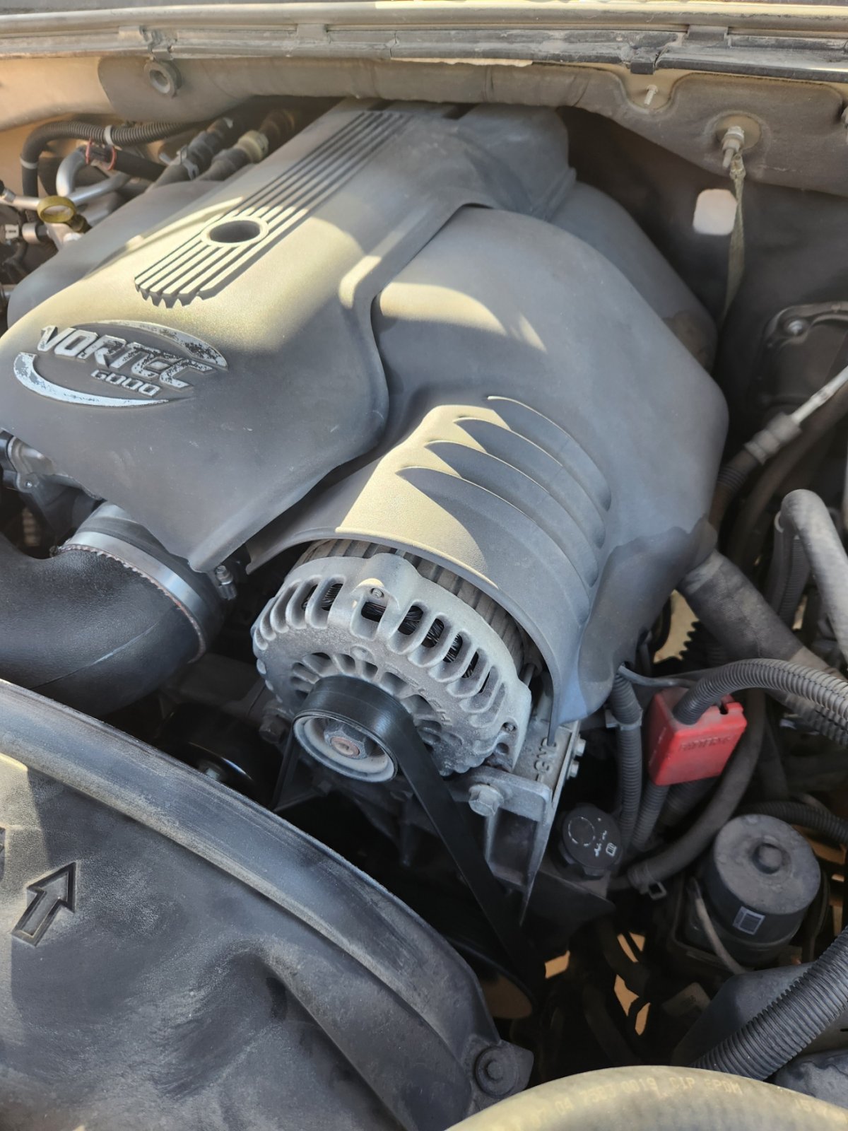

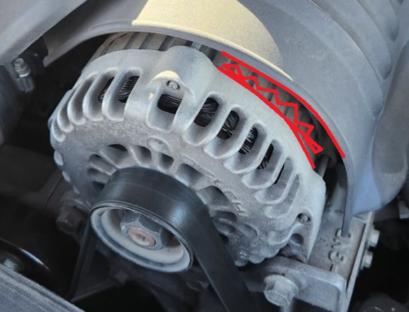

I figured it out.
There is a serial number and a stamp that says 145amp on it on the alternator
So its a bosche delphi 145 amp alternator
The OE 145A alternator has a black "spacer" between the case halves; the 105A one does not have the spacer. Glad you found the numbers on it.

The bigger output alternators need more stator coils so to be able to house those the rear case halve of the alternator has to be moved further back from the front case halve and spacers are added in between. Some fancy really high output alternators physically are bigger and/or thick front to back and may even require a custom mount for installation.
