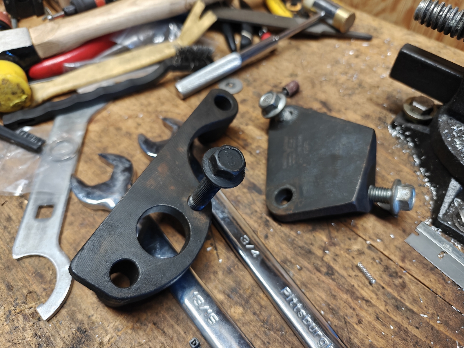

Mine was so bad. I had broken manifold bolts on the rear on both sides. I bought the Dorman clamps and it they did help a lot, but not 100%, because my manifold gaskets were also very worn out. But, they were a good stop-gap until I pulled the engine out.
I still have the two clamps, and you can have them for the cost of shipping and a beer.
When I installed the manifolds on my 6.0 I went with stainless manifold studs & nuts instead of bolts.
Appreciate the offer! I will definitely be in touch (with a beer) if I need them
