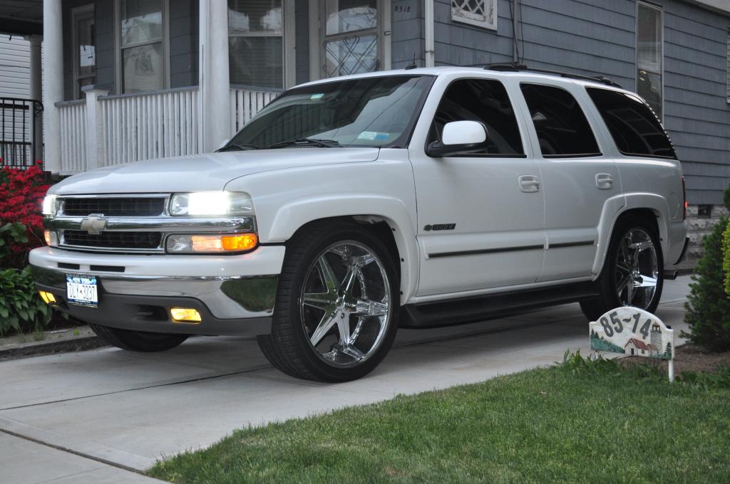

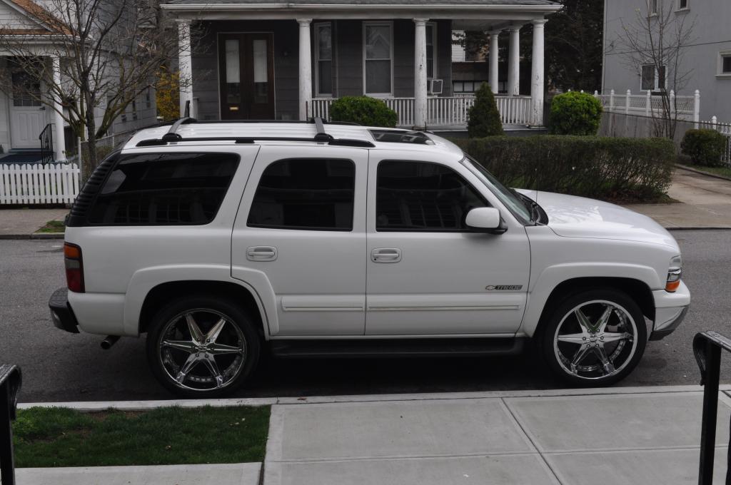

finally got her lowered but need to get out the kinks
a4edwin
Nov 14, 2011
948
239
ny
she was sitting at 36 front and 37 1/4 rear
now she's at 33 1/4 front and 34 rear using tony's 3-5/6 kit haven't done the free travel mod yet and need to move the sway bar over in the rear just had it done over the weekend so i know she'll settle some more. as soon as i get some time i'll finish off the mods

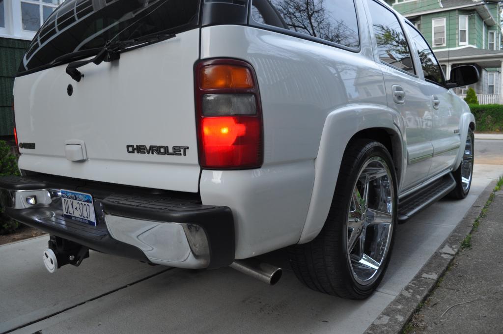

i'll also need to do something about my exhaust i have the flowmaster with the dual rear exit and it's smashing the shit out of the left pipe.

lookin good!

I had the same problem with the exhaust so i dumped it before the axle and that fixed the muffler problem

Looks really nice. Are those 24's on there?
Mike
yes sir.
i really wanted the duals out the back. and it's upsetting considering it only about five months old. but thats the hand i've been dealt.

in rear are you using the spacer?
Also in rear be careful once you cut bracket the pass side tire will push out more when the truck comes down might rub so might rub. The spohn bar will help that. You will like the ride

Lookin good Edwin. What size tires are you running?

running 305/35. she is sitting on the spacer. i also ordered the panhard bar with the kit waiting to install that when i do the free travel mod. time is not my friend need to figure out how to add 5 more hours to the day! once i get the sway bar in the right position is that gonna allow me to drop down more?

finally did the free travel mod dreaded the idea of the work involved but it was super easy and took about ten minutes to do both sides. didn't go crazy cleaning up the welds and with the bump stop tony gave me that tiny little lip isn't getting in the way. still rode like shit i was getting concerned now did i make a mistake going this low? my dual exhaust ran the left pipe over the panhard bar so i had zero clearance. took out the sawzall after work cut both pipes right in front of the axle. took her out for a spin and she rides ******* great! only problem is exhaust is louder and the drone sucks!
