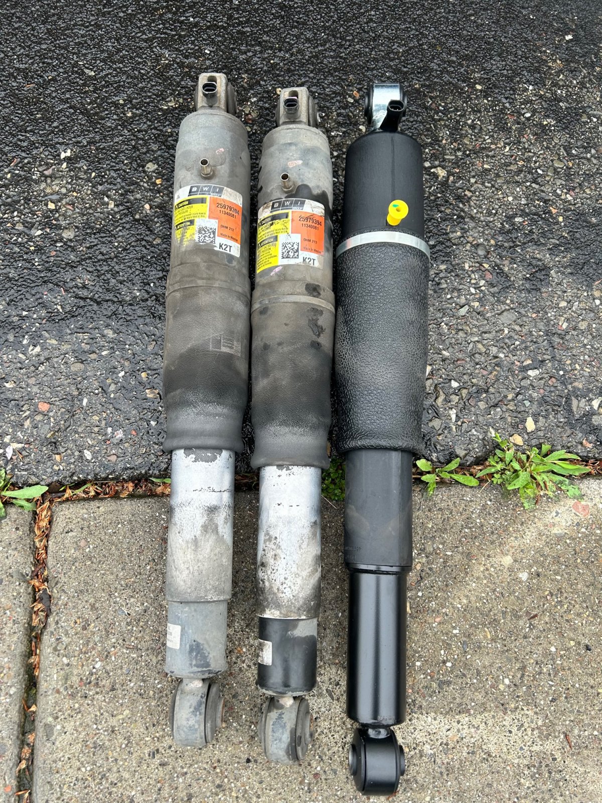

Hmmmm...weeeeellll... If either of your shocks are leaking at all, it will take out that new compressor in short order. You'd be better off just unplugging the compressor for now or pulling the fuse.

8,111
11,256
never heard of the compressor not "talking" to the computer. I did not experience that when testing a couple of bad compressors. 1 gave erratic data and the other had a leaking relief valve. 3rd worked fine and has been for like 4 years now
When @swathdiver referred to my finding, I could not find the shocks current air pressure reading on my Tech 2 with a Dorman compressor. The rest of the communication with the Dorman compressor were fine. But, to me, that omission was relevant to the troubleshooting procedures. Kind of like, if you don't know where you are, how can you decide on where to go.
weird I have the dorman and it shows the psi on the tech2View attachment 424964

It could possibly be limited to the specific Dorman compressor (defect?) that I bought, then, but I do not get that air pressure line in my Tech 2 readout.
might have something to do with the vehicle selection, you can try doing it with other years and see if it shows up then, mine is a 12
the worst that will happen is either it will error out or say unable to communicate. It doesn't hurt anything to probe with the tech2 with different years/vin selection

Thank you for that suggestion. I'll try that the next time that I have my Tech 2 out.

Getting a compressor with thermal / overload protection and a lifetime guarantee ensures potential leaky rear shocks won’t cost you a dime down the road. Having GM and many others offer lifetime guarantees with substantially lower parts prices makes this chassis a winner.
