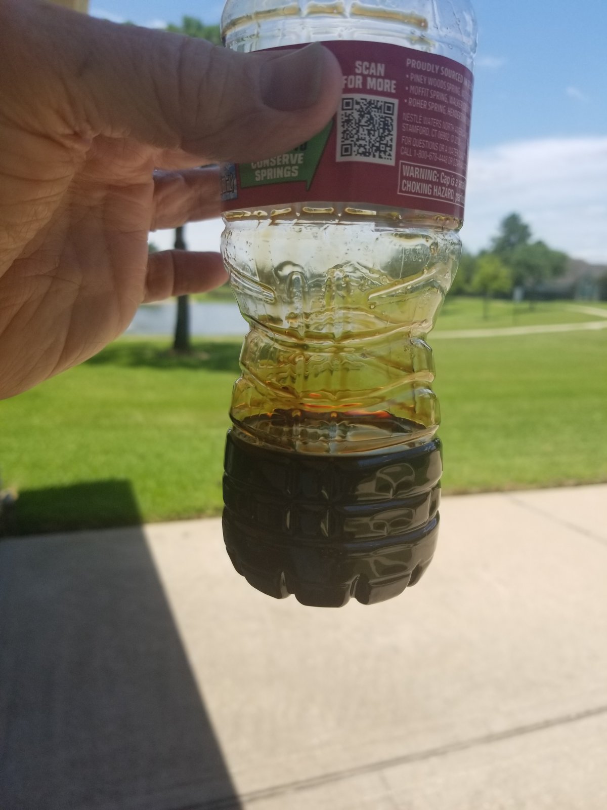

So what does the 3oz consist of? Mostly oil or other gunk? And is there a way to tell, short of having a chemist test it? ;)
Water, oil, and fuel. Not sure the proportions though. From what I can tell from my first use of the catch can it looked mostly to be oil.
