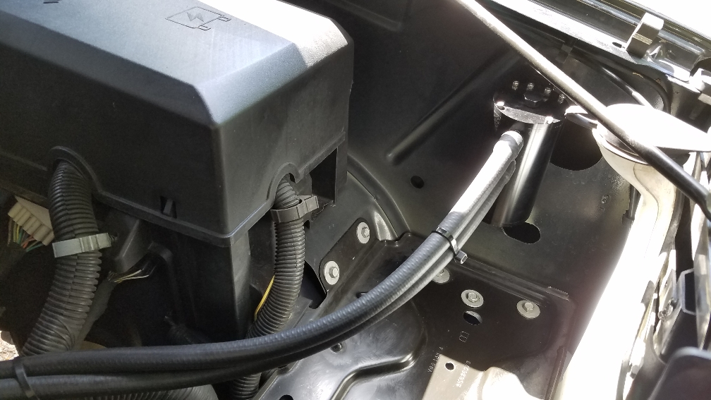

After learning of the catch can from all you great peeps, I finally got around installing mine. The Yukon already has 145,000 miles and it’s 14 years old. Better late than never, right?
Next order of business...putting steel wool inside the can (thanks to @iamdub on a separate thread for recommending this, and @kbuskill for explaining why to do it. ).
Here’s his suggestion:
https://www.homedepot.com/p/Scotch-...-CC/202511523?source=shoppingads&locale=en-US
I bought this one on EBay. Brackets are easy. Had one of these on my RAM. Worked great.

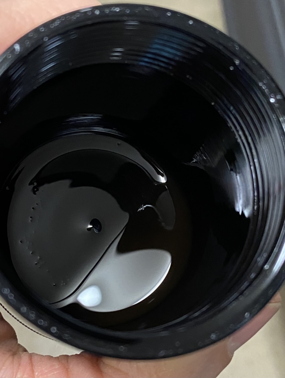

I did an oil change a few days ago and emptied mine. I would guess that I have driven 500 miles since I last checked this. It is about 12 ounces. My commute is about ten minutes now and I use the remote start a lot.
Wow! Hard to believe that crud would have ended up back in the intake!
Throw some strawberries on top and you’ve got a Chocolate Shake Special.
44,967
Short trips cause a lot of condensation to build up. Your local weather is a factor as well. The moisture content will be higher in the winter. That's just what's in your catch can, but it's almost the same as what's circulating in your oil system. Water eats bearings and makes oil corrosive. You gotta run that thing more!
This is good to know. Since Covid hit I’ve been working from home and the only use my ‘07 is seeing nowadays is the trip to the community mailbox down the block.
