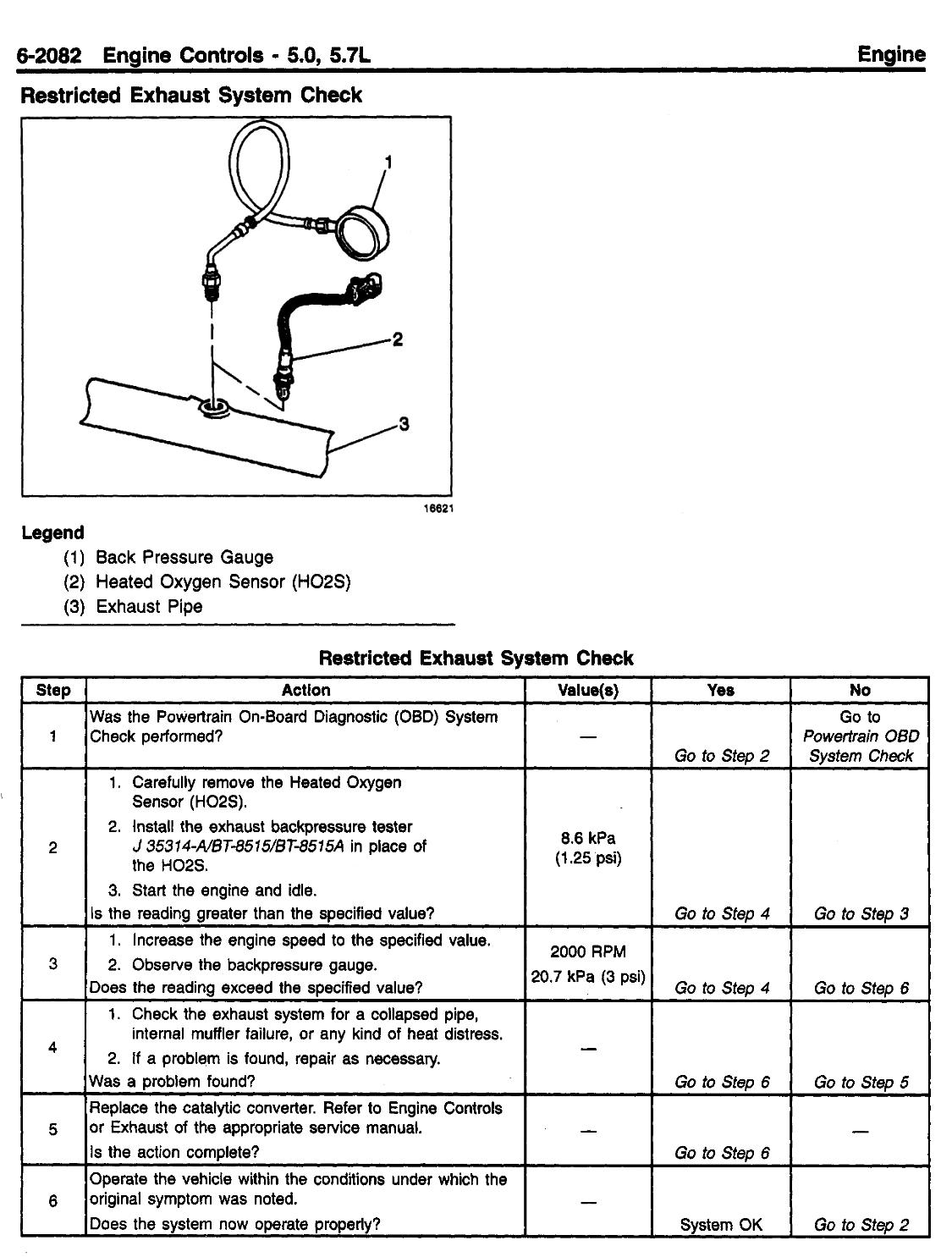

I would be wondering about catalytic converter back pressure. If you have an infra red temp gun, start the engine and let get warm and then give us front of and rear of temp readings at the cat(s).
The stumbling under load does sound like an exhaust restriction. You can get a back pressure gauge for around $40 on Amazon to check for damaged catalytic converters. Pull the upstream oxygen sensor. You’ll need a gauge with an M18 adapter which most come with. Also, some don’t come with a swivel fitting making installation a pain. A 90-elbow could be used to make it easier.
There could be two issues, though— The misfire causing the damaged converter(s) which then causes the sluggish performance. Does your scanner show misfire counts by cylinder?

Low fuel supply and clogged cat present very similar symptoms. I'm inclined to rule out the fuel supply (volume and/or pressure) since you're not getting any lean codes. Kinda suspecting a clogged cat. But, what throws that off is you said none of your issues happened before the intake manifold gasket replacement. Doing those gaskets isn't going to suddenly destroy the cat. Unless this started a little while after that job? Or was it right after?

As I said in the beginning, I still think you need to eliminate the cats as the source of the problems. Your problem sounds like cats or fuel pressure and I lean toward the cats.

Really sounds like collapsed muffler or Cat(s). I have seen similar symptoms and that was the culprit.
