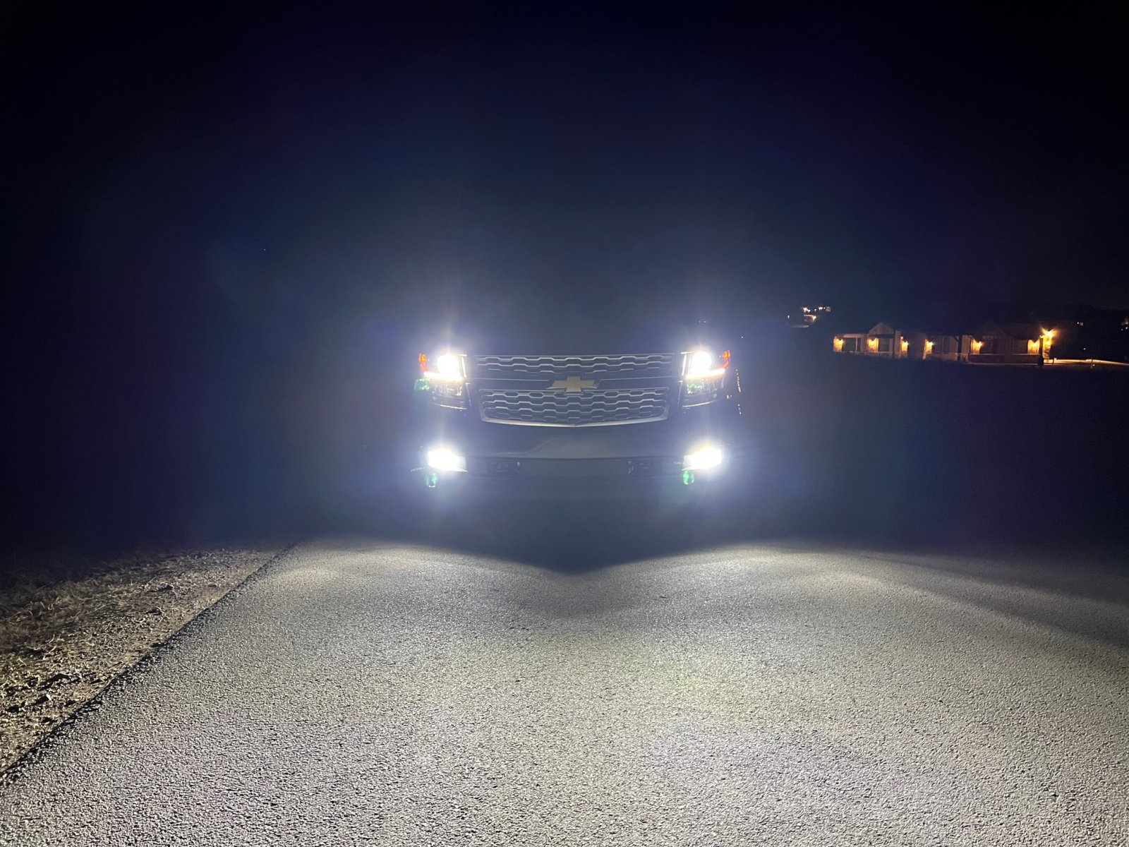

Is this picture just your lows and fogs?
If so, this output looks great! I would even say better than my OEM HID's in my '15 Yukon Denali XL even with OSRAM CBI bulbs.
I've been looking into a retrofit or at minimum a projector swap/upgrade to my OEM headlights. The output is terrible...
