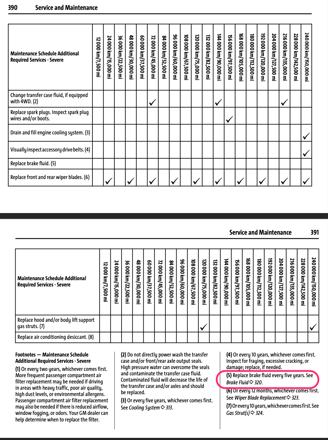

According to the Owner's Manual Service Schedule for Severe use (which 90% of all personal vehicles fall into) (due tot the short tripping):
Brake Fluid: every 5 Years
Transfer Case Fluid every 45,000
Transmission Fluid every 45,000
Coolant: Every 5 years or 150,000 Miles whichever comes first
Power Steering: There isn't any...its electric
Air Conditioning Desiccant: Every 7 years
I would also recommend front and rear differential at 45k miles too, but that one isn't in the owners manual.
Net, he isn't wrong about what maintenance items will need attention (although recommending power steering fluid is a bit dubious, since it is electric) but the service interval he is recommending is a little early.

Thanks. I’ll probably go ahead and replace the air filters. We’re in an area where the spring pollen drifts like snow. Wiper blades, too. But will hold off on fluids until severe service recommended interval. Didn’t find anything about brake fluid. Do y’all recommend replacing at some point, like when brake job is needed?
Brake Fluid is in the Maintenance Schedule, see footnote 5 (pink oval around it)
