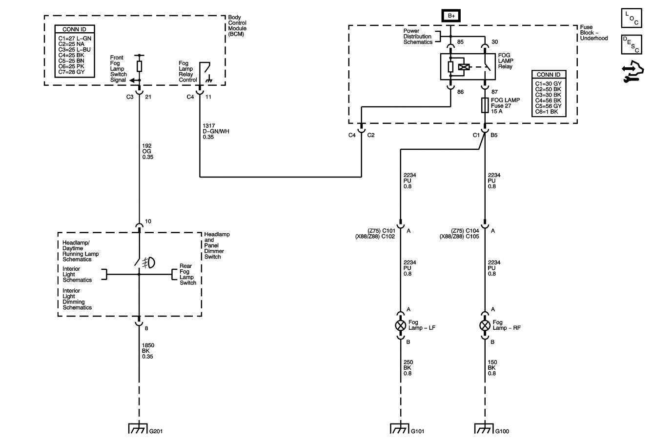

I will have to see if I can locate a wiring schematic for the switch (My GM Service Manual software only goes up to 2005). More than likely it is controlled by the BCM, though.
I would prefer if it was ON by default and the switch could be used to turn them off. Might be able to accomplish this with relays to reverse the output from the switch...but it all depending on the wiring.
