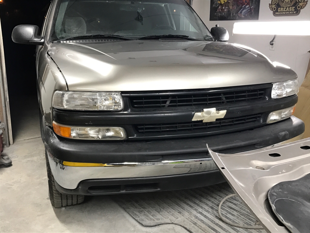

I have been searching for a few days and can't find any information on what size bolt/but etc that I need to install my fog lights in my new lower valence and bumper.
My Hoe came with no fog lights and no hardware so I ordered new lights/mounting assembly, but can't find much info on how they mount or what hardware I need.
Any pics or info would be greatly appreciated!

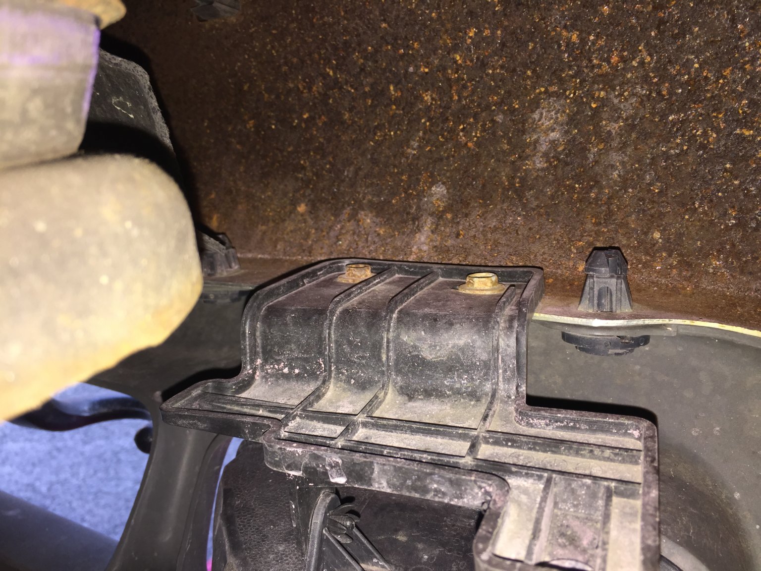

The fog light assembly should have 2 holes that line up with the 2 holes in the valance. You will need 2 metal clips like this that attach to valance.
The bolts are 10mm I believe. I can try to get you a pic tomorrow.

^^ bingo. I just worked on mine and my dad's, and I can confirm that they are 10 mil.
