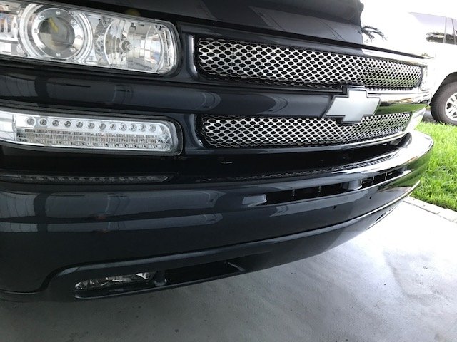

That Nano seal, does it dry clear?
Yes. It is stated to be hand applied only. I had a challenge because it was so hot, my working area needed to stay small so it wouldn't dry too quickly.
I still love finishing everything off with 1-2 coats of Collinte's 845 Insulator Wax. It is butter smooth and the water just beads off. Super easy to apply and wipe right off. The clay and 3M Machine Polish made a huge first and second step difference. Anything after that was a bonus IMO.

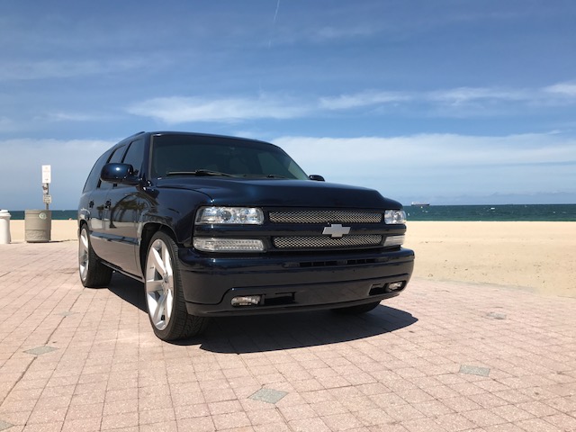

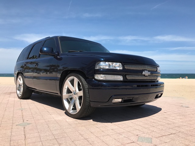

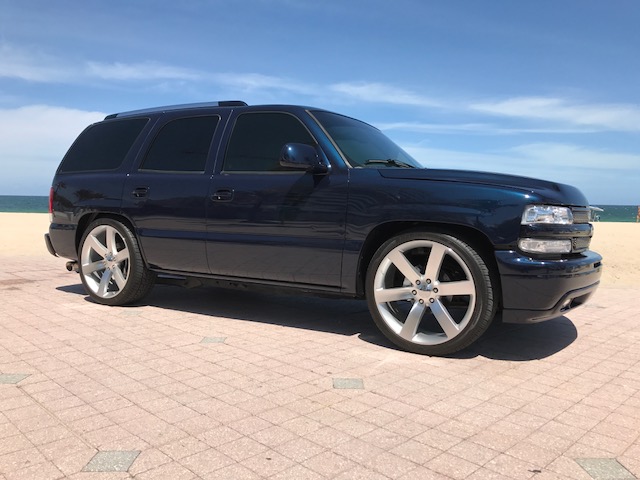

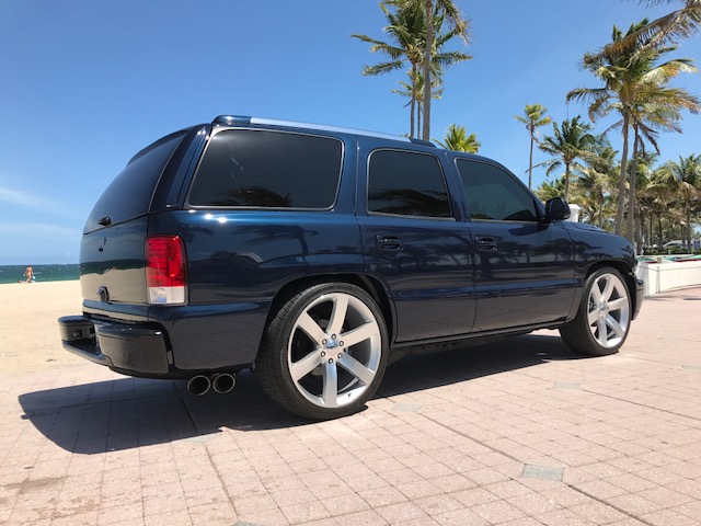

No mods to mention this post. Pulled the cover off her after 2 months away and she was still looking shiny. That truck cover was worth every penny to keep the UV, rain, dust and anything else off the paint when she can't get the TLC each week.
