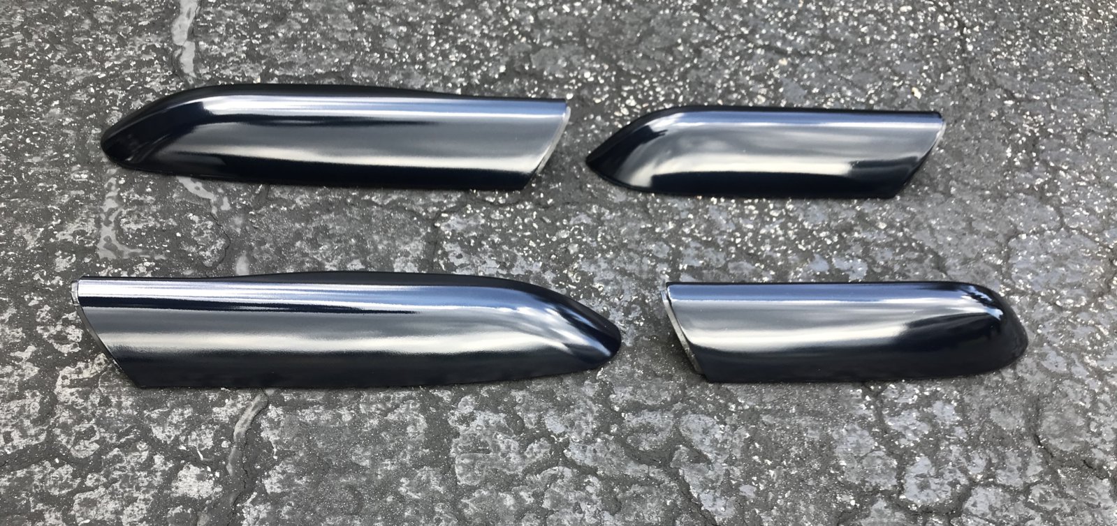

Just had a thought , do Silverado/sierra truck handles match up with ours? Different years? Or other vehicles ? For color options ...possibly grey or black.
Little fact for today , the dome lights are the exact same ones I had in my 2005 Dakota.
There are quite a few interior pieces that are used in other make vehicles. Not made by gm itself but made by the same outside company.
