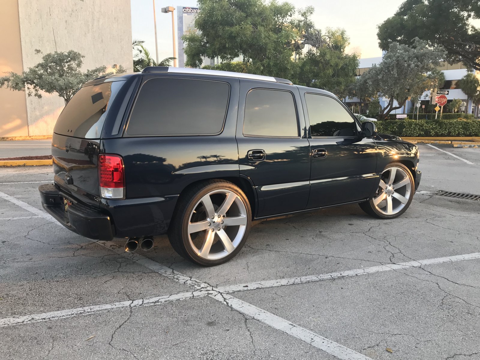

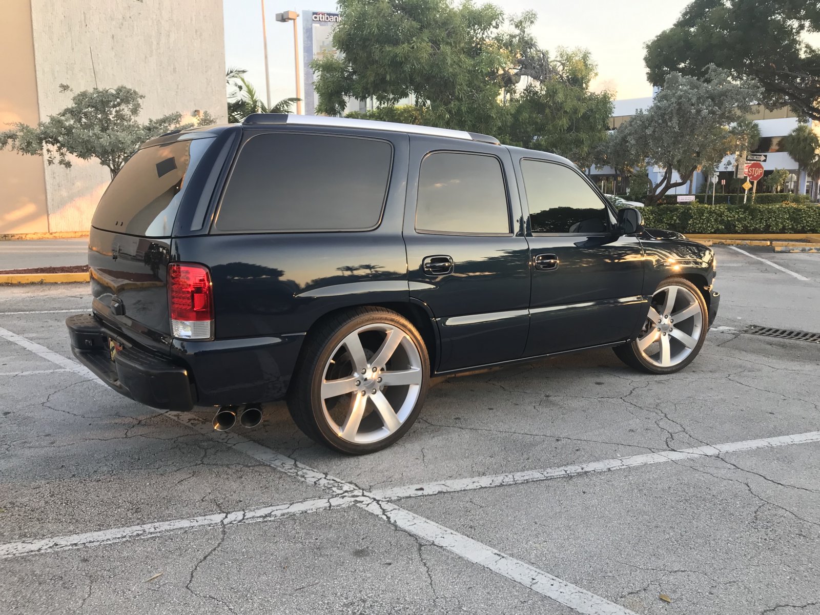

I took her for a spin to Home Depot today as it was sprinkler repair day and hit 76000 miles on the way.
