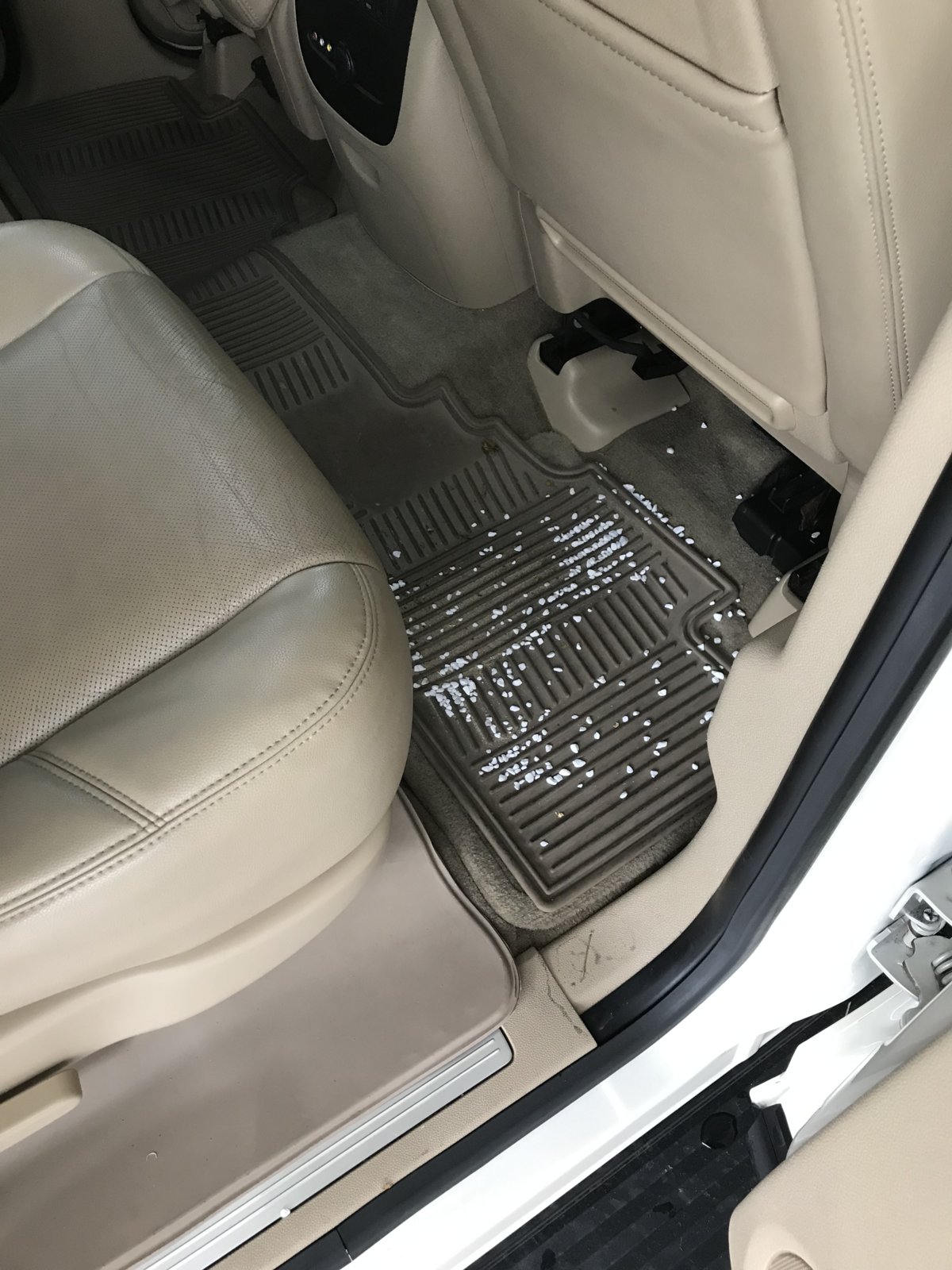

Gave the truck a wipe down with Lucas Oil Slick Mist and shined up the tires. Took a few photos just because.
