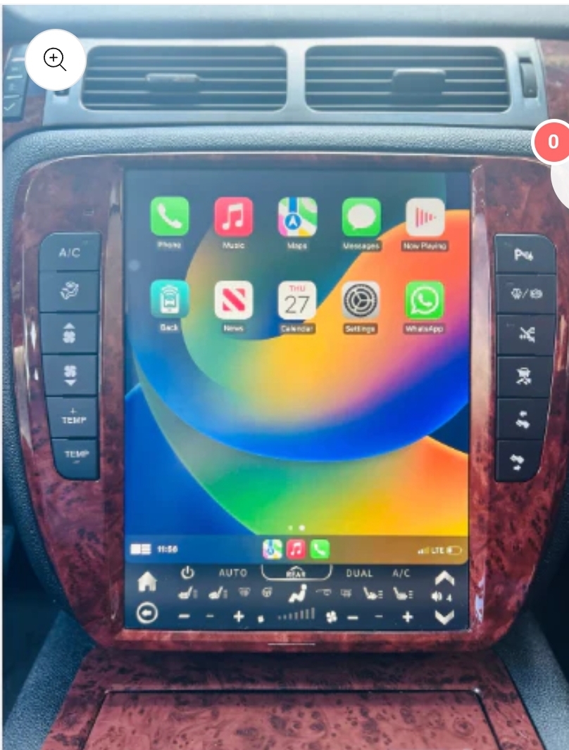

Found a 12.1 android head unit that incorporates HVAC factory system controls
mackmcmillan
Aug 16, 2017
63
43
This is my issue though, they should be able to figure this out as the original HVAC head unit, from what I remember, display or controls don't turn on or work with out the key on.
Something to test I guess with the new one
I follow this and only hope there'll be a time when they have that worked out AND a version that works for us who don't have the upgraded HVAC controls, etc! I'm a bit sad there's enough difference to basically disqualify my ride. Ugh, a physical bypass could be done for it, but wouldn't look stock and if the turning it on/off before it works type thing is real, then it's certainly a no-go!

Are you going to be testing the integration of the rear screens and the factory wireless headphones? Also testing if the hvac turns on with remote start or if you have to physically turn it on as shown in some videos.
Sent from my SM-G965U using Tapatalk
JJ351
Mar 16, 2017
67
59
CA
I've never used the rear entertainment system, so if it doesn't work it won't be a big deal to me, but I'll try it here. Likewise for remote start
JigglesZ71
Jan 16, 2020
9
Definitely let us know about the HVAC turning on and heated seats with remote start as well as the rear fold down screen.
I read in some comments on YouTube that someone did somewhat confirm that the heated seats and heat turned on with remote start.
I would like someone to re-clarify that, but it would make sense if it does because that would most likely be coming from the HVAC controller circuit board that you need to reuse on this unit.
i think that the 4gb with Android 9 would be the only way to fly on this.
also from what I have seen the cigarette lighters are no longer used and will need to be taped up. And it seems the drivers pedals and backup sensors and traction switch can be utilized within the unit.

Just got off the phone with PAC and they stated that this cable should fix the issue with the Rear Screen.
https://www.amazon.com/PAC-GMRVD-Ov...579188200&sr=8-1#immersive-view_1579192787470
Also further investigation shows the steering wheel controls are retained and functional on this radio however the voice function will not work but looks like a work around is downloading google assistant. Also noting that this does have a built in microphone but apparently has the ability to use a External wired mic.
I most likely will be getting once of those as well and installing it in the headliner rearview-mirror area.
