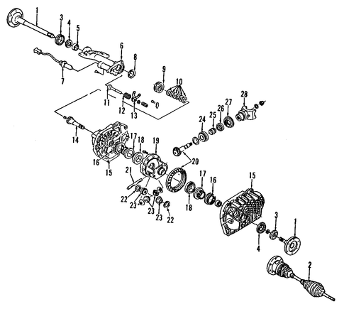

Ive had the seal replaced twice now. Once under warranty and it still seems to leak either where the axle inserts the differential or at the flange. Any ideas?

Did anyone ever check the axle dia with a micrometer or just toss seals in it. Sounds like the same problem with the 2nd gen dodge rams. Even tho its rubber against steel the seal will eventually wear a groove in the shaft and it will never seal correctly.

Well if it was supposedly checked to find out what was going on and it still leaks it sounds like someone didnt actually do the job as they claimed. Probably just tried to rush it out and tossed seals in it. Id pull the shaft out and check it for any variations in the diameter using atleast a good caliper. Sometimes it doesn't take much just a few thousands depth of a groove and it wont seal right.

Dont think so. I think the diff sits too far back for the font seal to be leaking onto it. Other than the seal or the axle spline being grooved I cant think of anything else that would cause it. Although the guy that put the seal in says the axle is fine.
