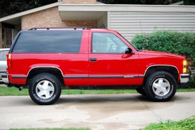

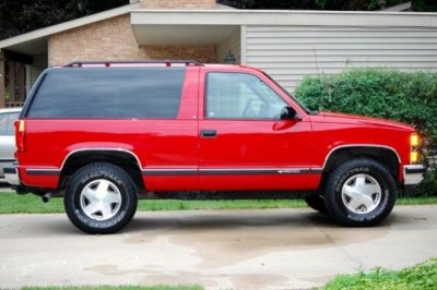

Ok guys so my 1996 2 door makes a clunking noise in the front end (approximately the drivers side) when when going over bumps in the road. Let me give you some background first. My 2dr has 55k original miles. Yep you read that right. Sat for many years before I came across it this year. Was in a concrete floored barn and is in super shape. I've changed out all the universal joints, shock absorbers (Bilstein HDs), sway bar links, and tires (Goodyear Silent Armor (LT265/75R16s). I've got the tires aired down to about 65lbs or so. Still pretty bouncy but no more flat tires on job sites.
I've checked that the shock bolts are tight front and back. I tightened the sway bar links and squashed the urethane bushings in doing so. But not too squashed. I put the hood up and leaned on the truck pretty hard. I can hear the sway bar bushings squeaking that surround the sway bar itself and fasten to the cross member. The bug deflector seems tight to. What the hell is it?
