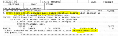

See below:
Highway3
Sep 23, 2020
22
California
I have had the same issue. Reported it and they claimed to have fixed it but it hasn't improved.
I'll share B520044's fix and see if they can try again...

They ordered a part for my. "service restraint system" alerts and did a software update for the sensor alert issue. seems 80% as stable as my 2015 now
I wish it would switch to my parking cameras automatically a bit more reliably, but much better! Great vehicle so far
