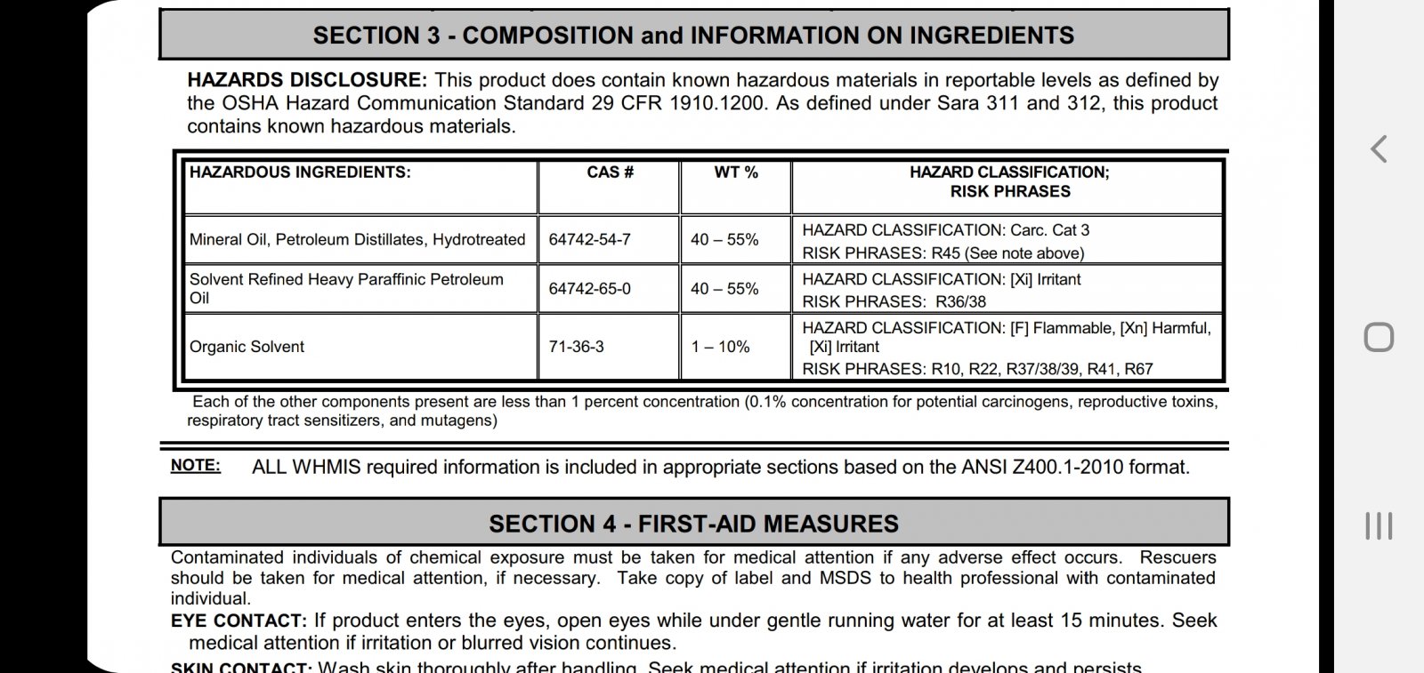

Went ahead and looked at the oil additive
Flash point of 142f, pour point of -5f, and a 100c viscosity of 27.5 centistokes? What in the world is this stuff? It'll evaporate when the engine gets halfway hot, form a brick on a cold morning, and is as thick as a 140 weight gear oil.
I can't even say it would change the VII of an oil cause it would evaporate off. Which, if it does, whatever's left behind would be thicker - best case, or a particulate, worst case. At least in the former, it would tank the VII of an oil.

It's mineral oil and lube oil.
Here's the older version.
