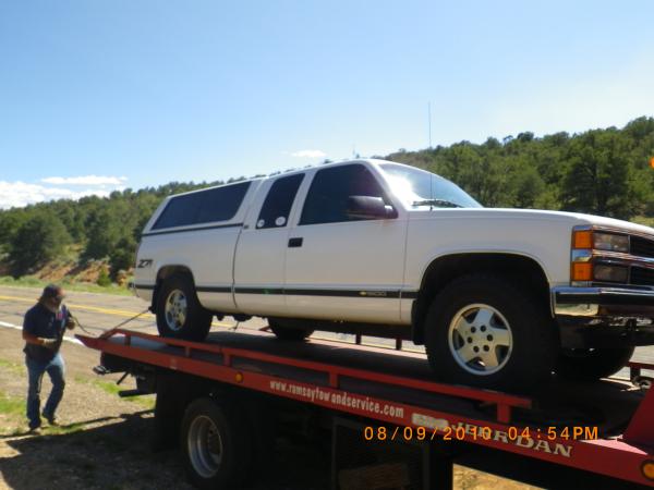

I had a fuel pump put me on the side of the road in my 1995 K1500 last year with 135,000 miles on the clock. It wasn't exactly the middle of nowhere, but it was the North Rim of the Grand Canyon with no cell phone reception and nearly 80 miles to the nearest town. A nice lady hauled us 16 miles out of her way to get to a phone. I bought an 80 mile tow and fuel pump in Kanab, Utah. It killed pretty much a day of the trip, and wasn't cheap either.
So, with my recent acquisition of a 1996 Yukon with only ~50,000 miles on it, I felt pretty safe taking off for parts isolated this summer. During some extensive slow going above 9000' in Bangs Canyon, Colorado, my fuel pump started whining. I was nowhere near anything a tow operator would call a "road". The feeling in my stomach wasn't great.
The fuel pump held up for the rest of the trip but when I got home I had the local GMC dealer order and install a lifetime parts and labor fuel module. That doesn't mean I won't ever be stranded in some desolate area again, but I've hopefully improved my odds.
I tell that long (boring) story to illustrate why I would be inclined to replace it now with the best part I could afford. If your life (or at least significant inconvenience) doesn't depend on this truck running, you can do like lots of folks and run it till it quits and have a buddy tow you home.
ETA: and change that fuel filter the first chance you get.
ETA: Pictures that goes with this story.
