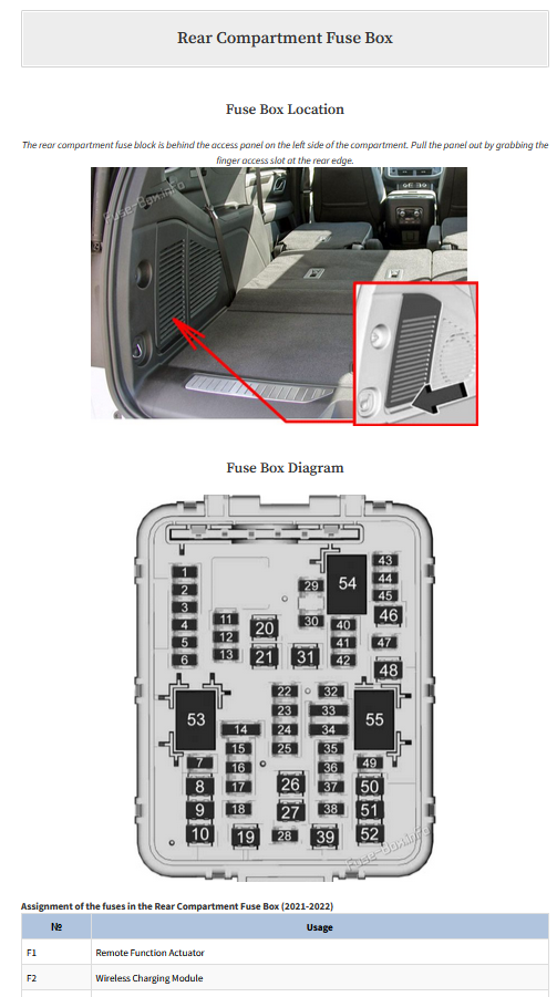

Hello. The wireless charging pad on my 21 Yukon Denali just randomly stopped working. It worked fine in the past and actually stopped working while the phone was charging. Could anyone help me identify the location of the fuse assuming there is a dedicated one for the wireless charging pad? I’ve been scrounging around and can’t seem to find the answer.
Thank you!!
