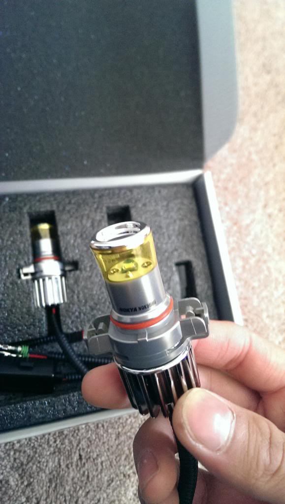

Foglights are Nokya Foglight bulb in ricer yellow

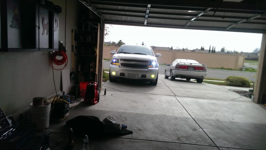

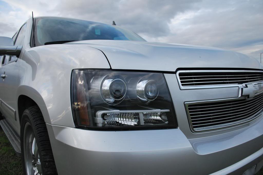

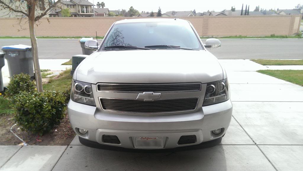

First here are pics of my completed retro
TRS Reppin

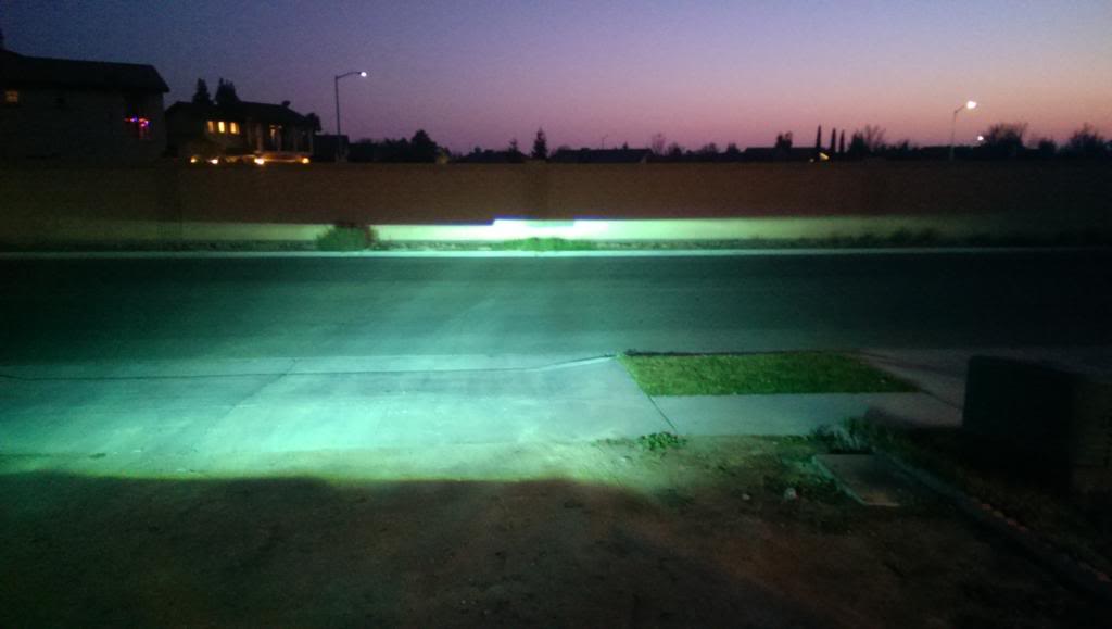

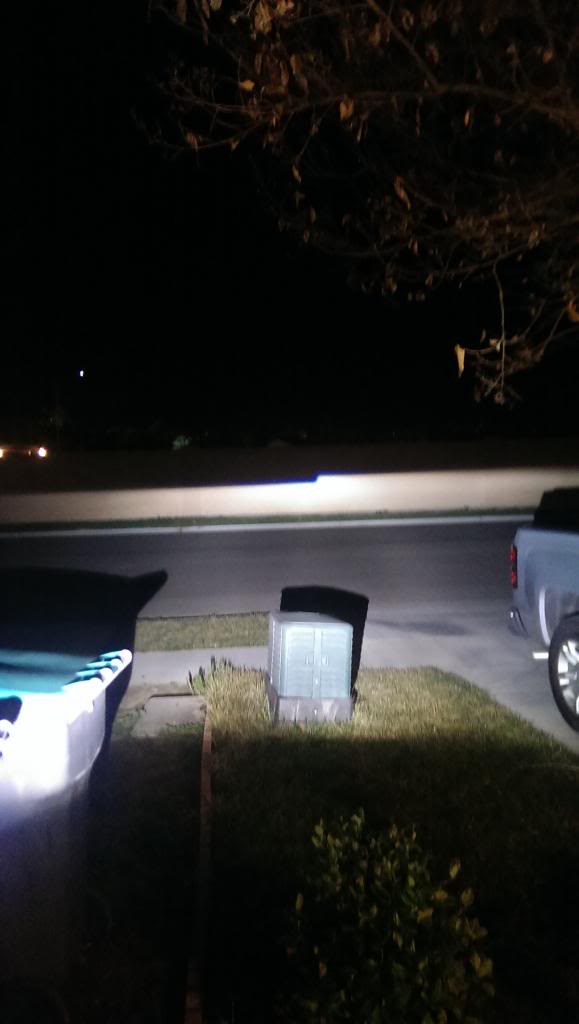

Output

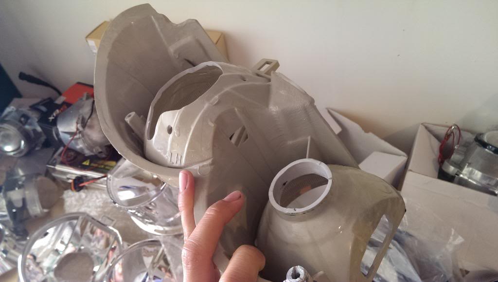

Beveled Corners of Projector that was trimmed
Grinding Reflector for clearance, the clear wrap was to keep the dust from flying all over.

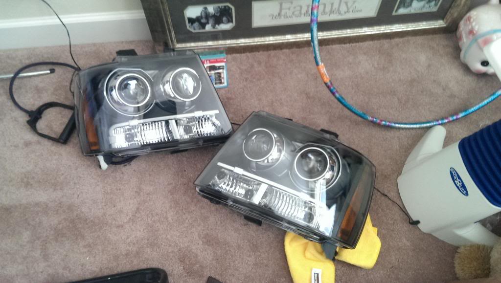

Test Fit

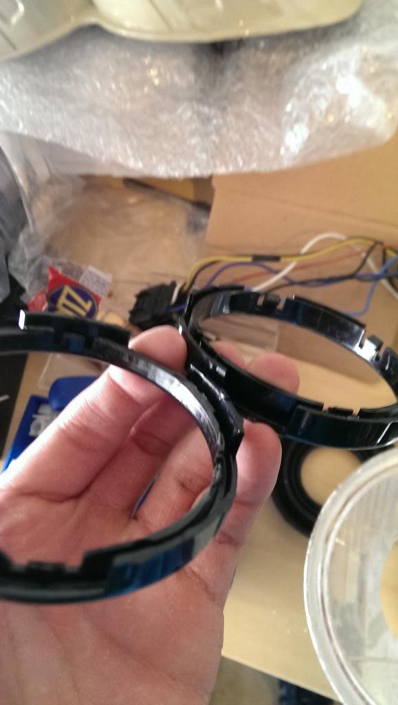

Shroud Ring needs inner ring trimmed to sit edge of shroud closer to projector due to how insanely close the shroud is to the headlight lens in the end. (actually it makes slight contact)
Test shroud and projector lens holder ring painted black to match MH1 black plastic lens holder.

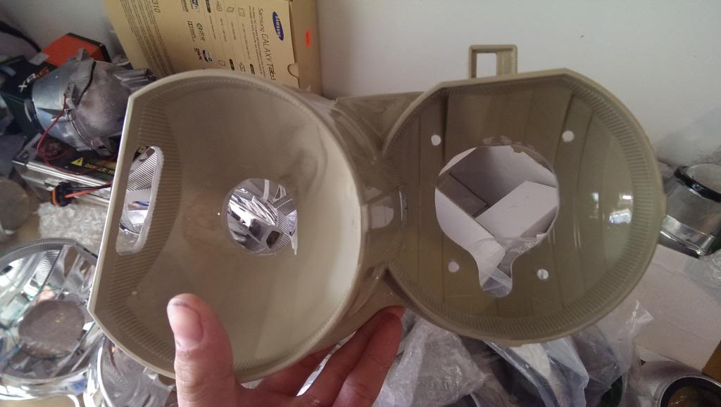

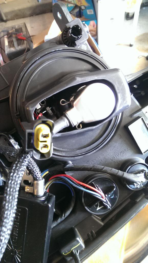

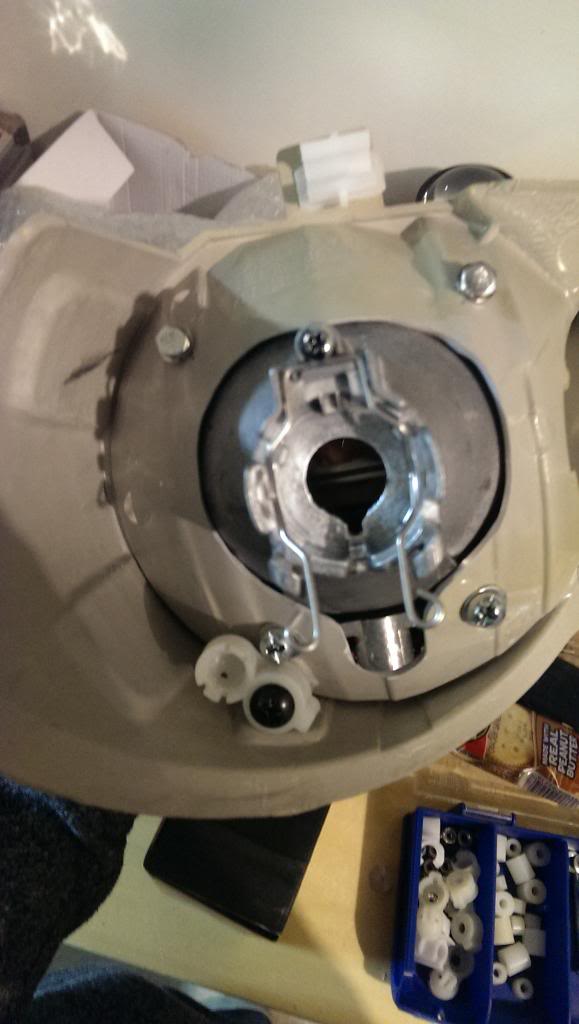

Area that needs to be cut to accommodate extra bulk of the FXR and D2S connector
Test Fitment

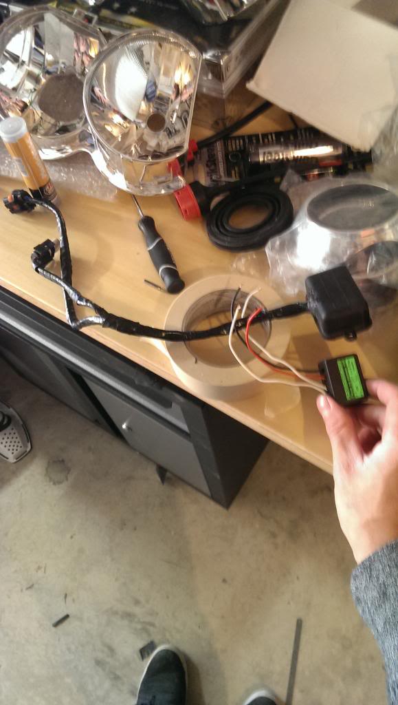

New and old relay delay timers

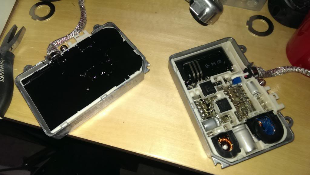

Potting Densos using MG Chemicals Thermally Conductive epoxy

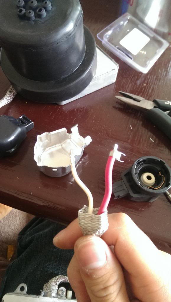

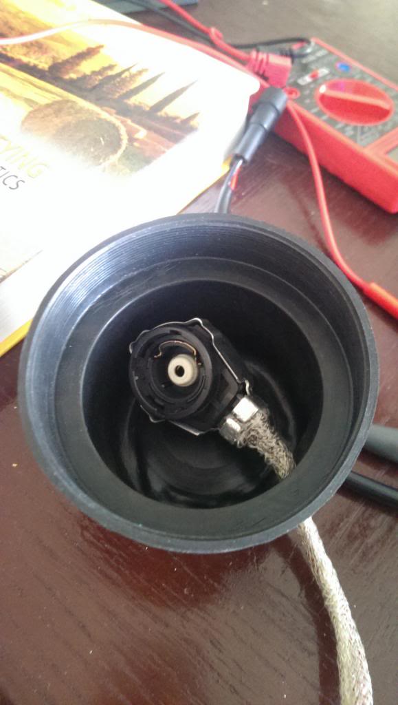

Depinned Denso D2S plug so that I can run it through the rubber boot
Back of headlight

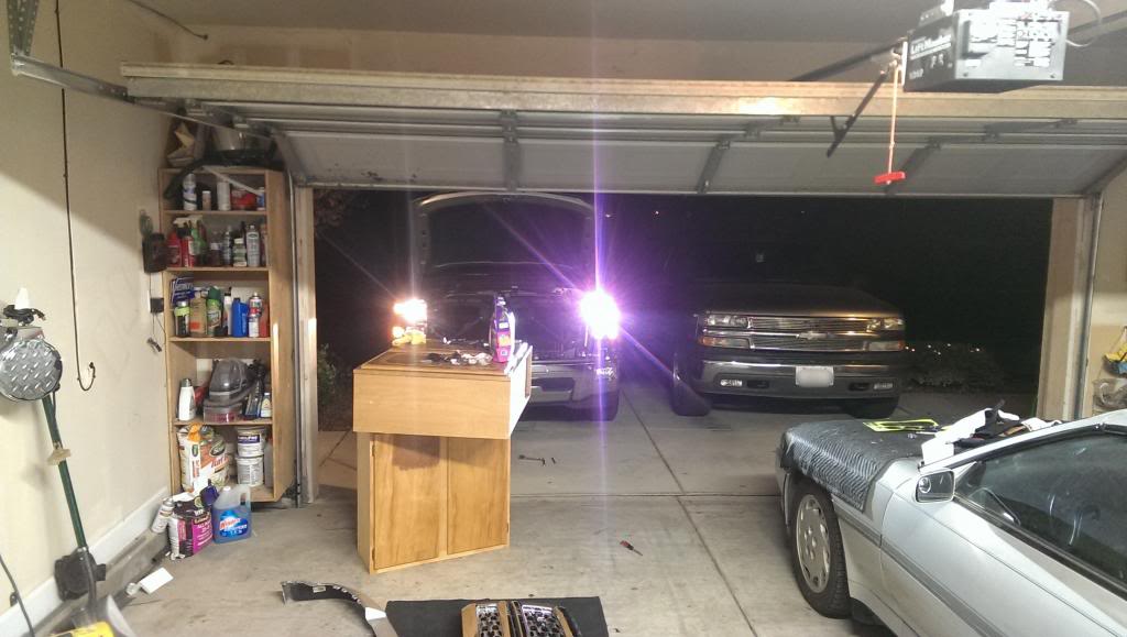

Dat purple flicker doe (quote I use a lot between my friends with retros)
Plastidipped Grille
Phone makes output look green, its 4300k, very halogen looking

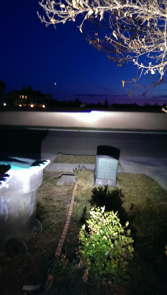

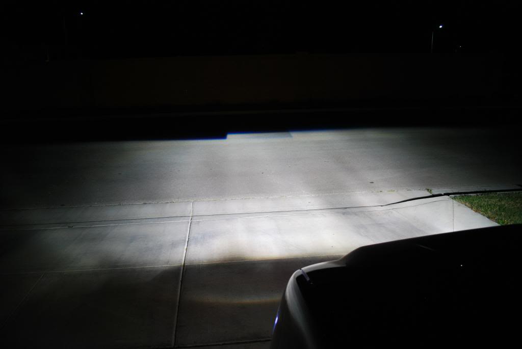

Thanks, no I only have FXRs on the low beam bowl, a FXR would never fit the high beam bowl, I tried to fit the new D2s 3.0 in the high beam but that too will not fit. The D2S 3.0 have a pretty good output, from what I can tell however, they seem to have a lot of foreground lighting which isn't beneficial for a truck. I will upload a "comparison" pic of the FXR and D2s 3.0 in a bit. I quoted comparison since it was taken at different times so it isn't much of a comparison.
Mini D2S 3.0 using XB35 5k bulbs and Denso Ballast (photo was taken for a friend that wanted a output shot with a bulb that is affordable lol)
FXR 3.0 2.5 inch lens with same bulb and ballast, taken later at night.
As you can see, the Mini D2s has more slightly more foreground light. Obviously though this isn't the best comparison of the outputs.
