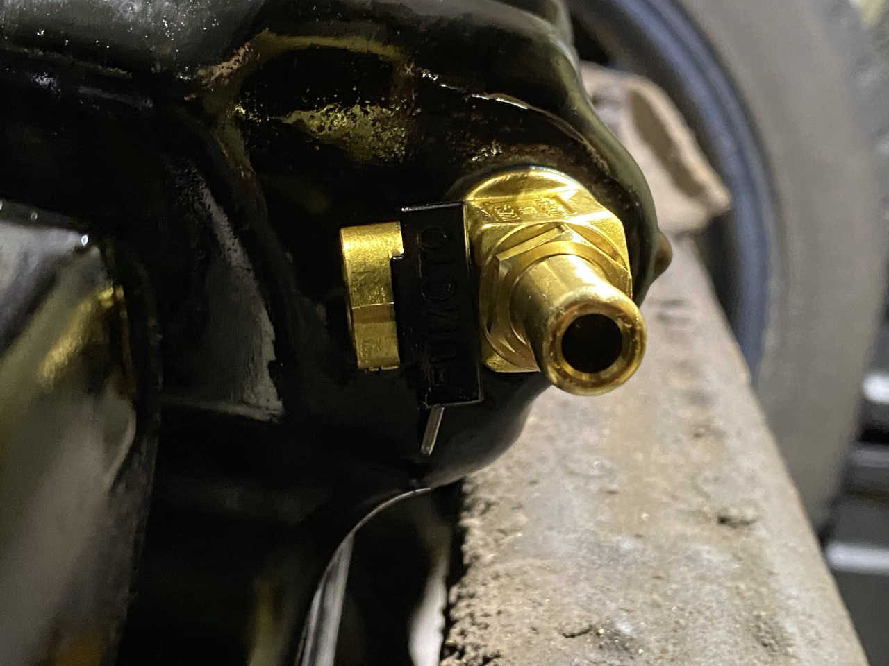

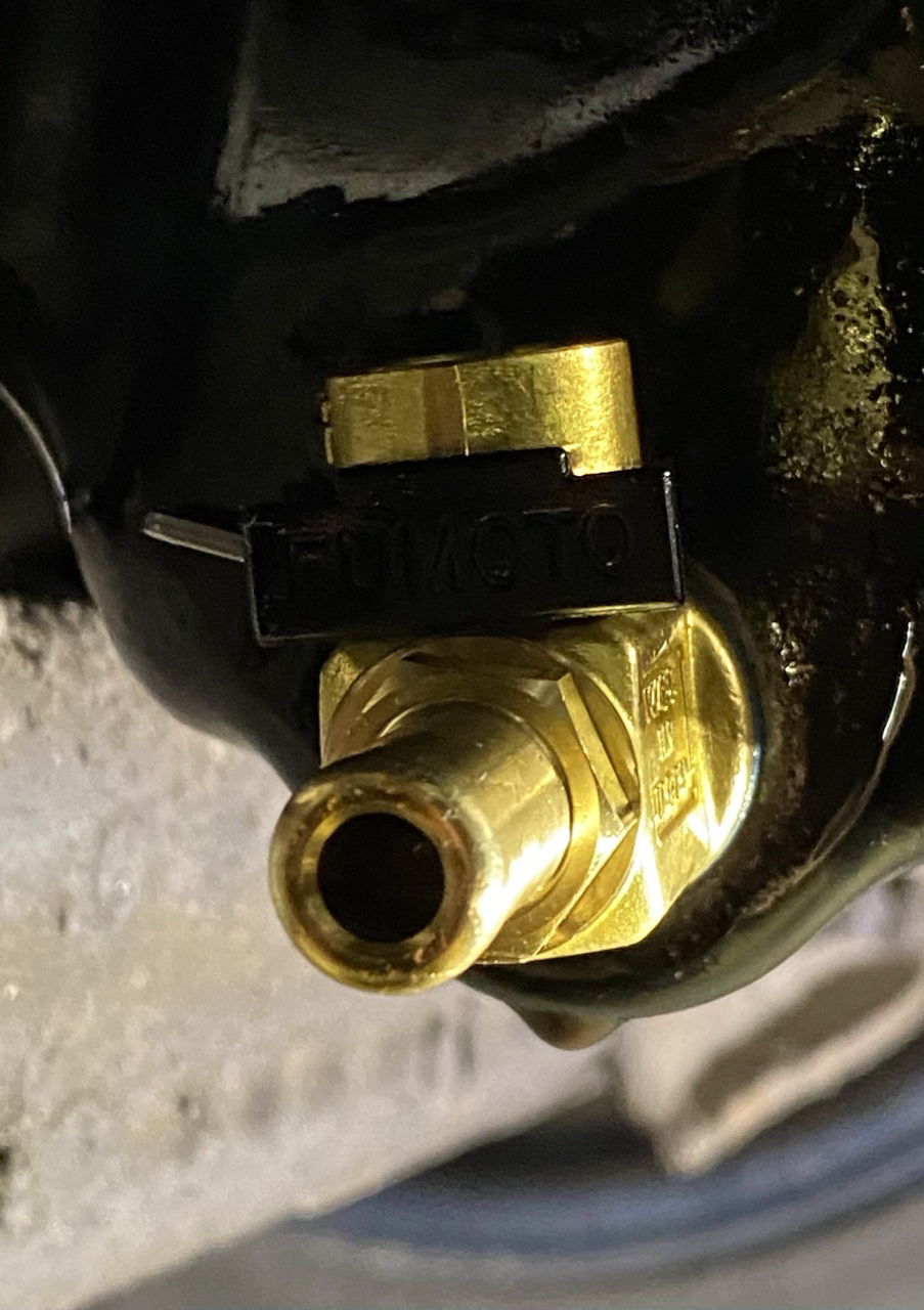

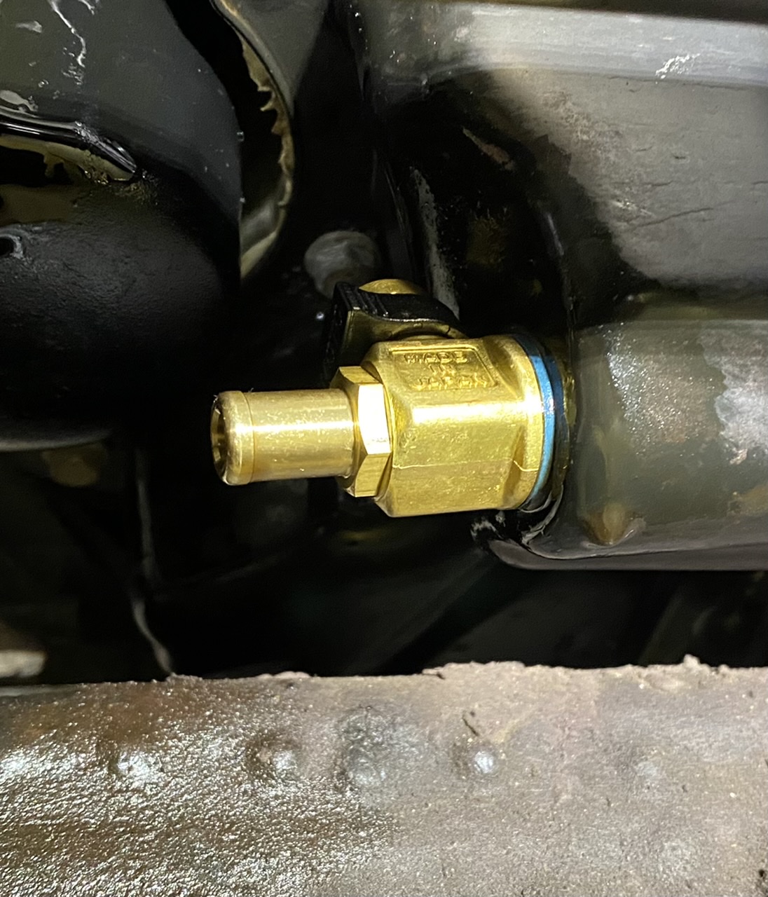

Installed the Fumoto Oil drain valve 12mm-1.75 threads tonight. It will definitely make changing the oil a little less messy and easier. I got the F107N (N stands for the added nipple) with a locking clip. One downside is I couldn’t thread it so the valve lever is visible, but doesn’t matter...still is super easy to open the valve, shut it, and lock it. Some pictures...
They make a cap for the nipple, but forgot to order it. Will be adding that soon!

i wouldnt mind the valve being hidden/protected... simply add a piece of hose and no mess
