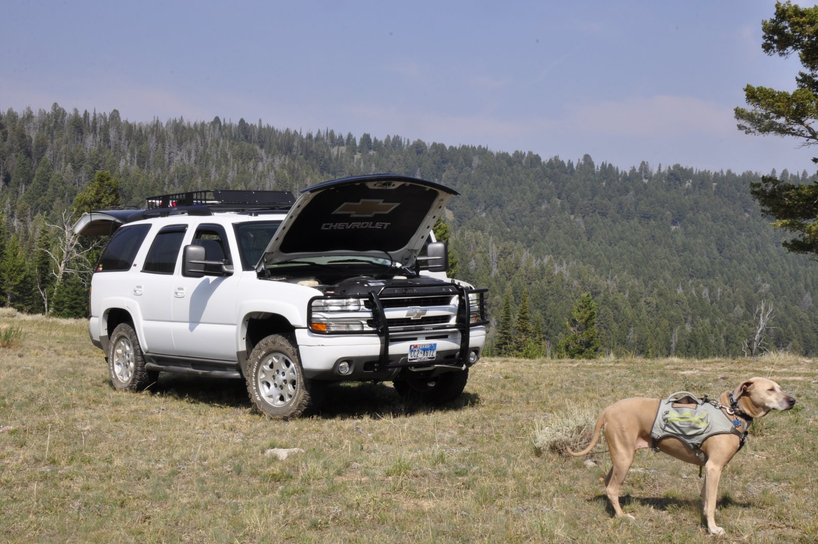

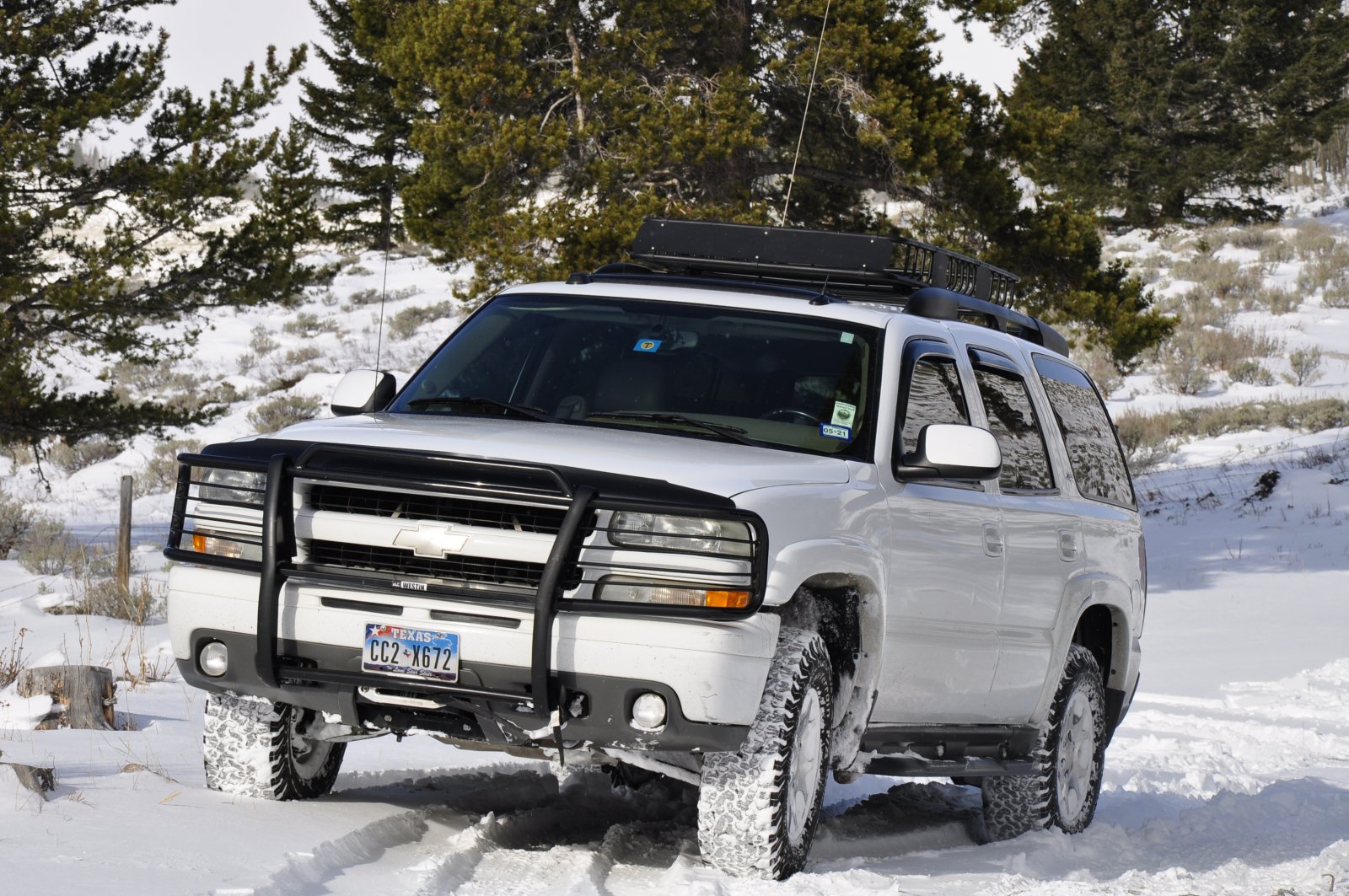

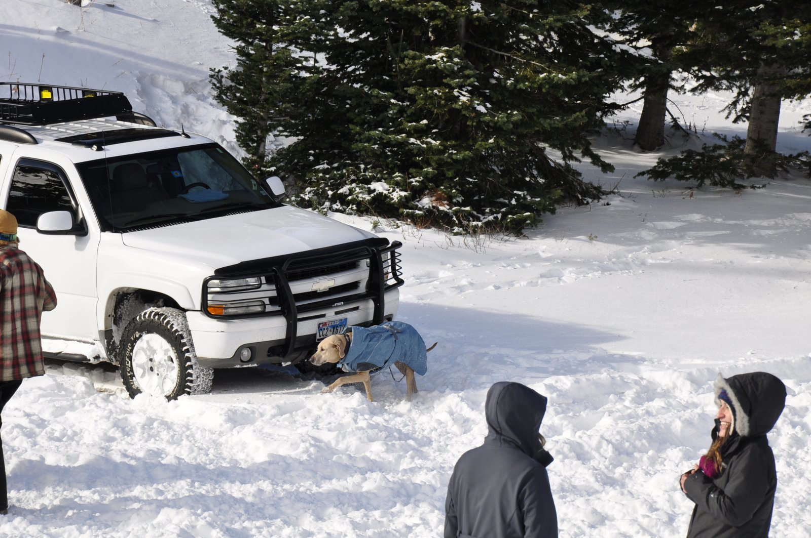

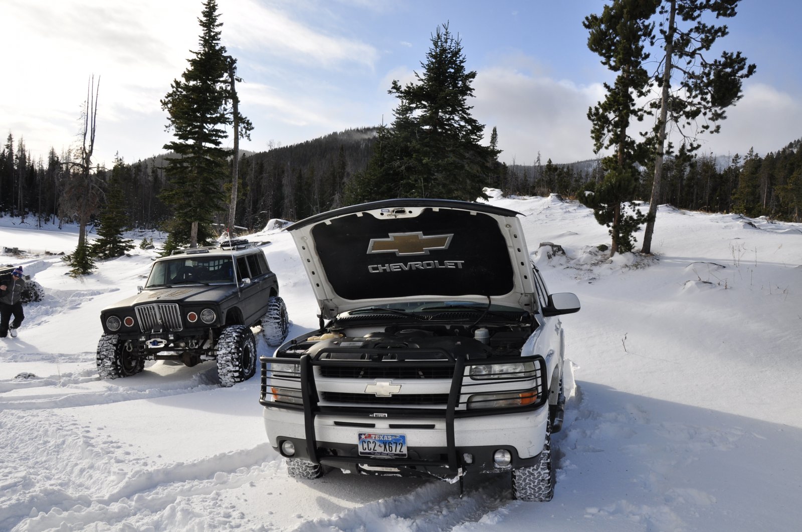

Someone made a snorkel for these years ago, also fit the 900s. Look at the Avalanche forums, those guys used lots of them.
Almost lost my motor once, went into a stream and took a nose dive, water splashed over the hood and up the windshield. About a year later I nearly did it again when the truck fell off a submerged rut and water almost came inside the passenger side window that was open.
Those outdoor pics are great!
Where did you get the underhood insulation with the logo?
