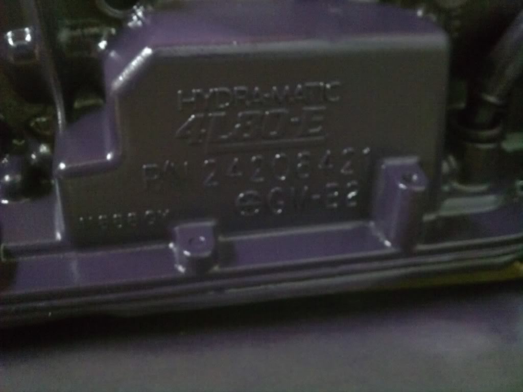

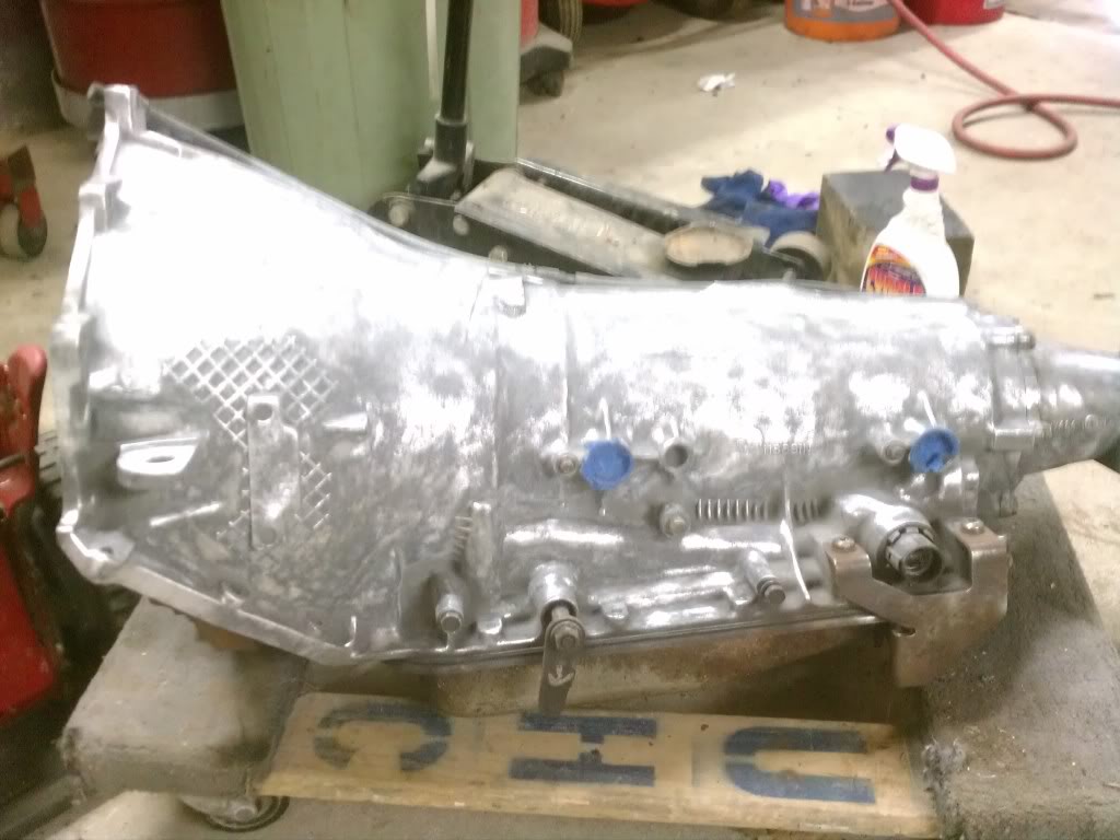

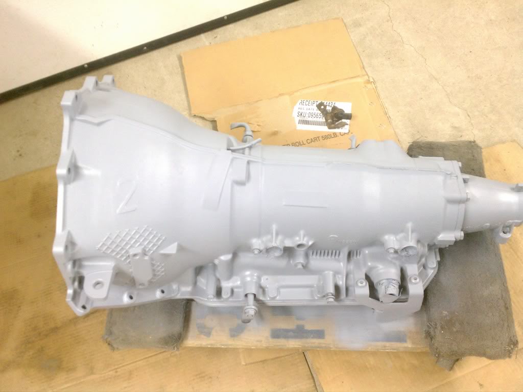

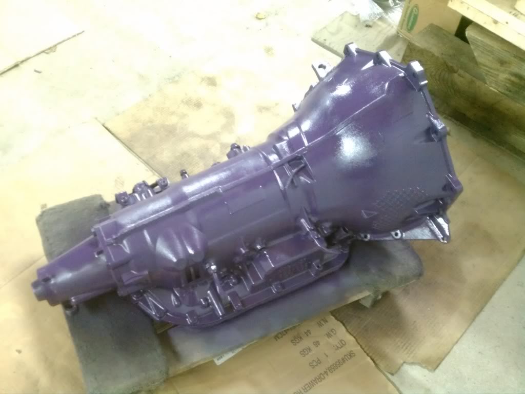

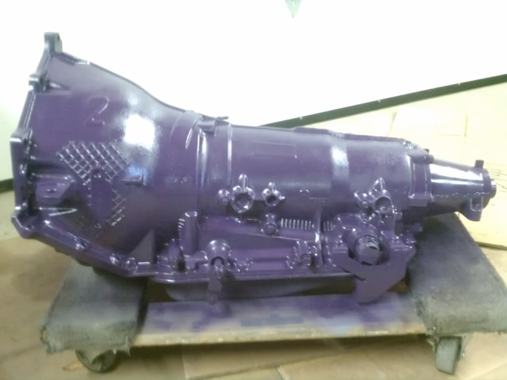

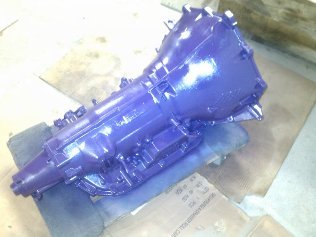

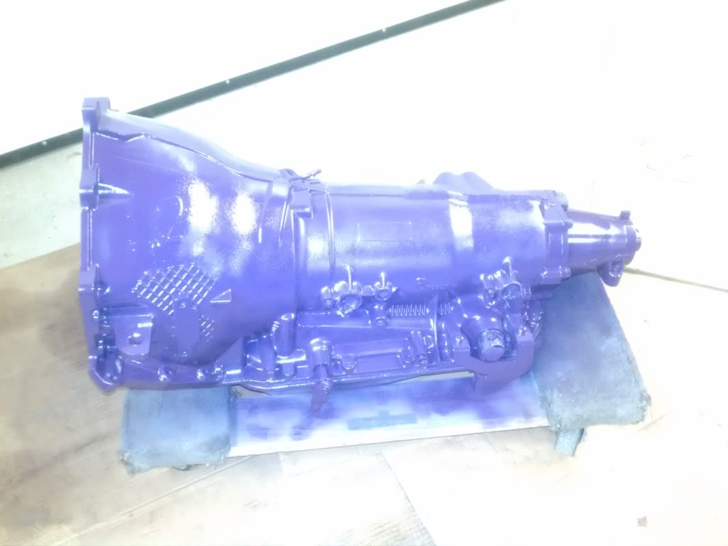

Next is transmission which is getting a Trans-go HD2 Shift kit, new pan and filter. Painting it purple...it is time to swap!

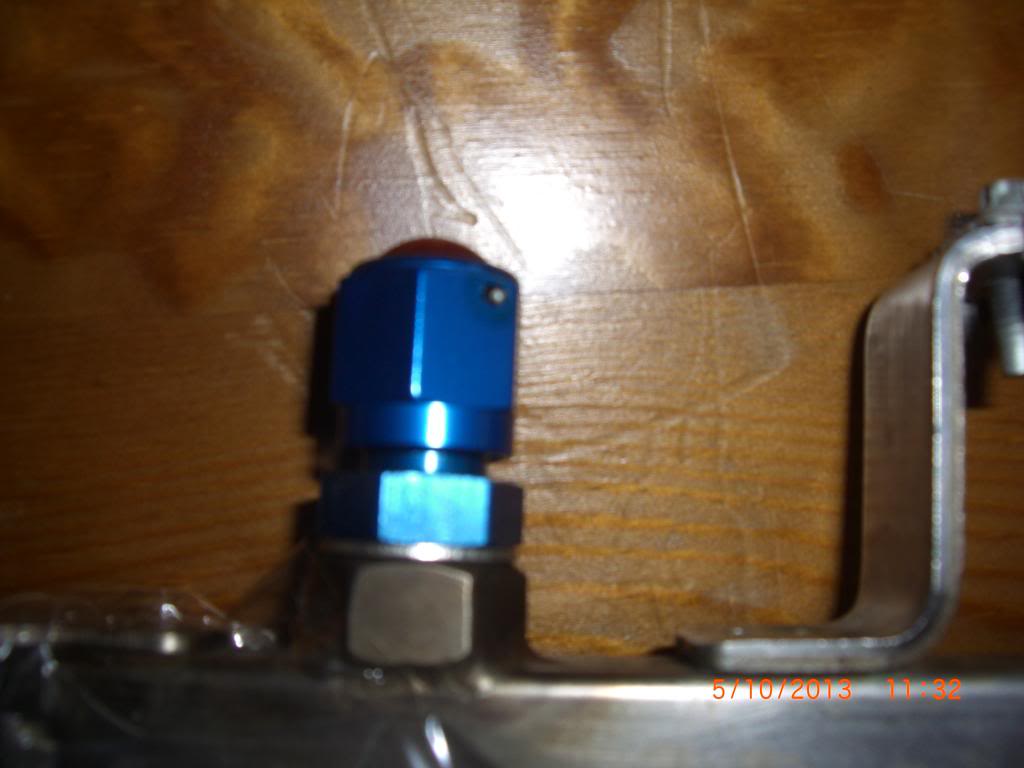

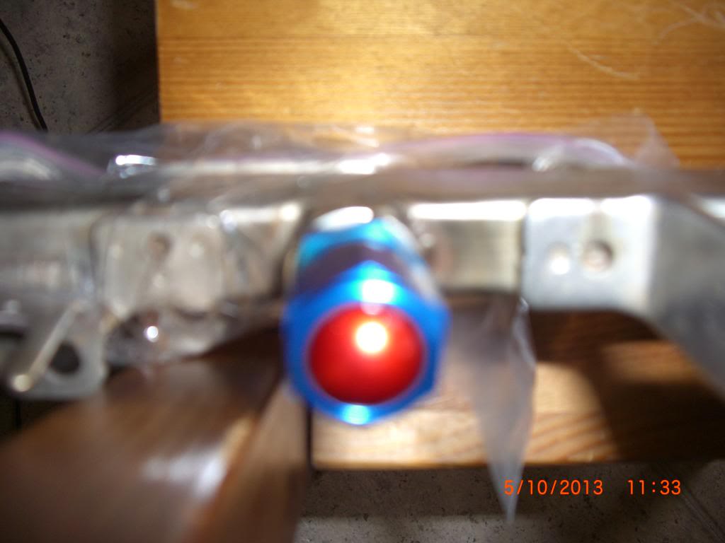

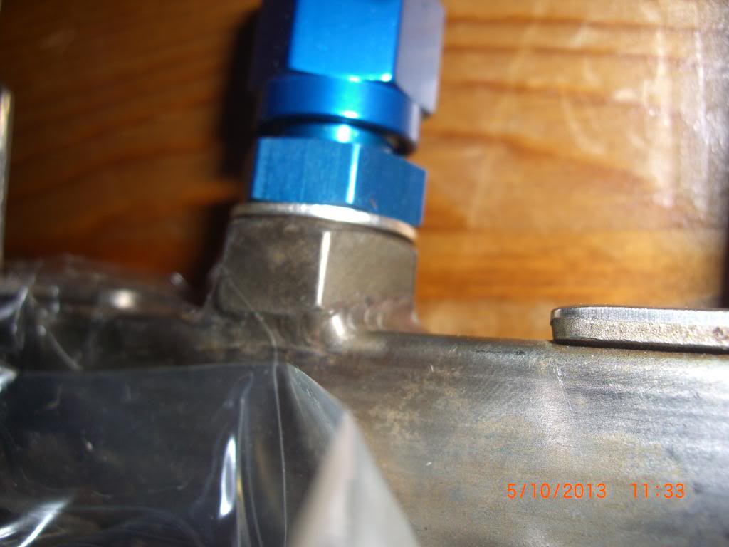

I have modified the stock LS Fuel Rail with a AN fitting...so therefore I will not need a Corvette Fuel Filter
AN Fitting Part Numbers ARE
Here are the Summit Part Numbers to refresh your memory and the Part# for 6ft. of line.
SUM-240606BP PREMIUM BLK NYLON HOSE -6/6FT Quantity: 1
RUS-640850 EFI TO 6 AN FITTING Quantity: 1
RUS-640860 FUEL RAIL TO -6AN Quantity: 1
FRA-491971-BL O-RING SEAL FITTING BLK Quantity: 1
EAR-9894DBHERL FEMALE 14MM X 1.5 SAGINAW Quantity: 1
SUM-220690B -6 STRAIGHT BLACK HOSE END Quantity: 4

1) New Transgo HD2 Shift kit
2) TRU-COOL MAX 47391 TRANSMISSION OIL COOLER BY LONG Heavy Duty without Bypass Kit
I choose not to get the bypass kit, here in NY will never be that cold IMO and I like the fact that the cooler my fluid is the better off I am since HEAT KILLS Trannies!
3) New 2wd Actuator
4) New Tranny Filter and Gasket
5) Deep Pan
******* Converter...not sure which one to go with.
