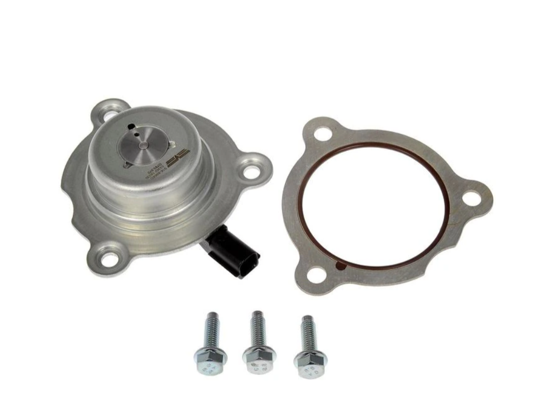

The VVT solenoid, as well as the actuator that screws into the end of the camshaft and holds the pulley on as well
Is the VVT solenoid and actuator one or two parts?
Everything that I see is that it’s 1 part and they label it as “solenoid/actuator” unless I’m missing something. So that’s why I was confused with the Melling kit because they have a “VVT solenoid/actuator” in the kit but you mentioned to go genuine GM

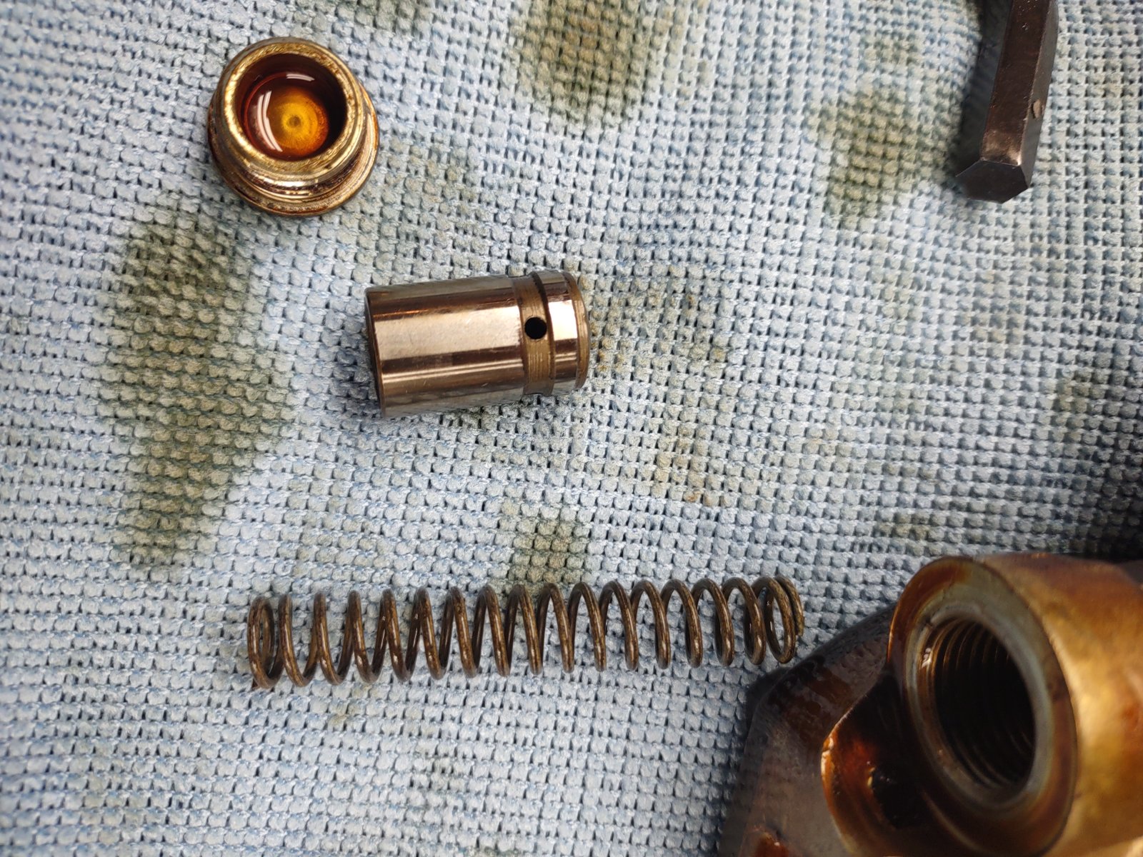

And when you remove your oil pump, take out the oil pressure relief valve and see if there's crud inside. Here's what the parts look like on an oem pump. Note the spring seems kind of corroded.

There's a solenoid on the front of the timing cover.
Then you have the actuator that goes through the camshaft pulley and threads into the camshaft. Some websites listed as the camshaft bolt.

The solenoid that mounts on the outside of the timing cover
