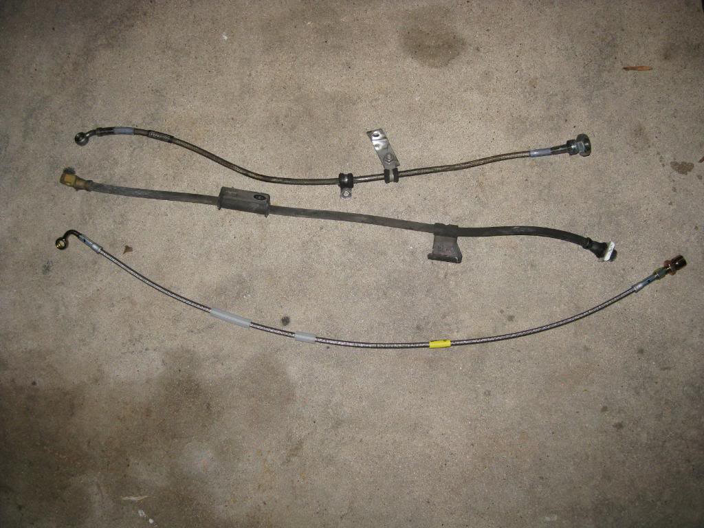

Talked to Butch and ordered up kit #14182 which he said was the best match for my application. However, it seems the lines are much too long. Now, Goodridge does say on the package that their lines are 3/4" longer than stock, but these are definitely longer than that.
Here's a pic. Russell SS line on top, OEM in the middle and Goodridge on the bottom.
So, what gives? Has anyone else had an issue like this? Pics below for reference.

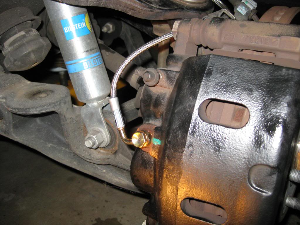

Following the instructions, I began routing the line from the caliper.
Used the stock hardware.

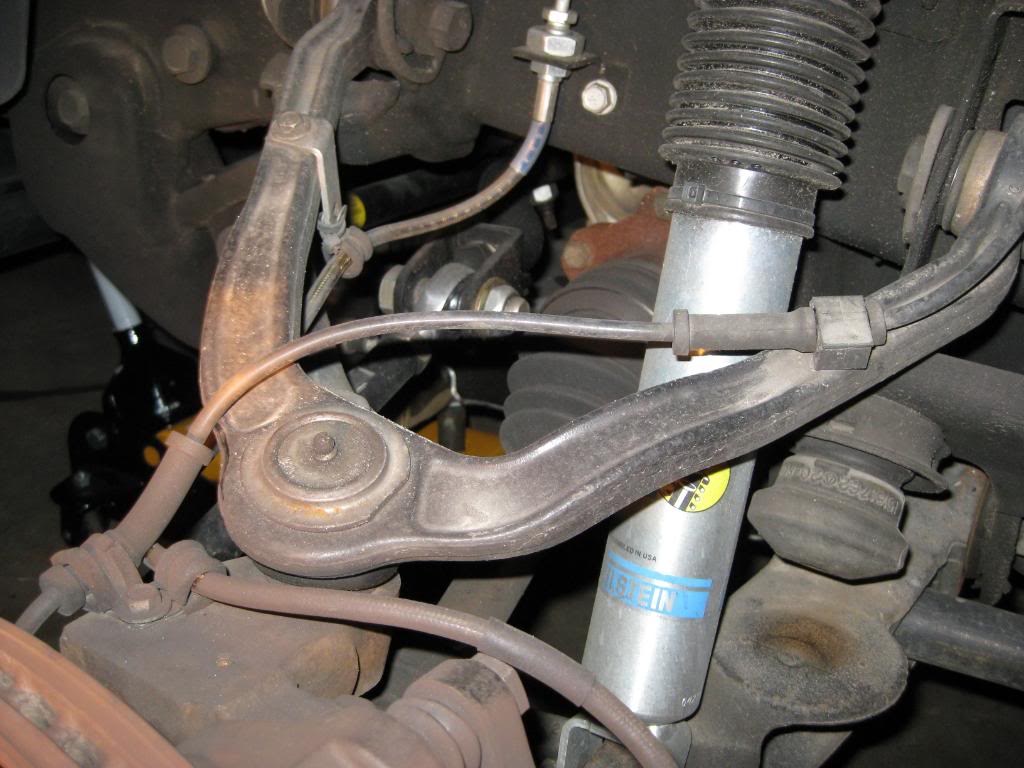

Here's where the main issue lies. As you can see, there is way to much line from the UCA bracket to the frame. So much so, that the line contacts the front UCA mount and brushes against the tie rod when I articulate the steering.
