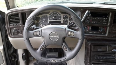

Hasn't blown up yet. Installation was smooth n easy. Had to fab a bit to get the control cables through. Nothing a razor blade couldn't handle. The airbag is out of an 06 denali envoy. Snaps right in. No codes. Looks great in my Denali. I'll never go back. Im still waiting for the black back cover to come in. Definitely recommend it. Gives it a factory but custom look. Clean. If anybody wants a more specific photo lemme know.

Here's another pic for the viewing

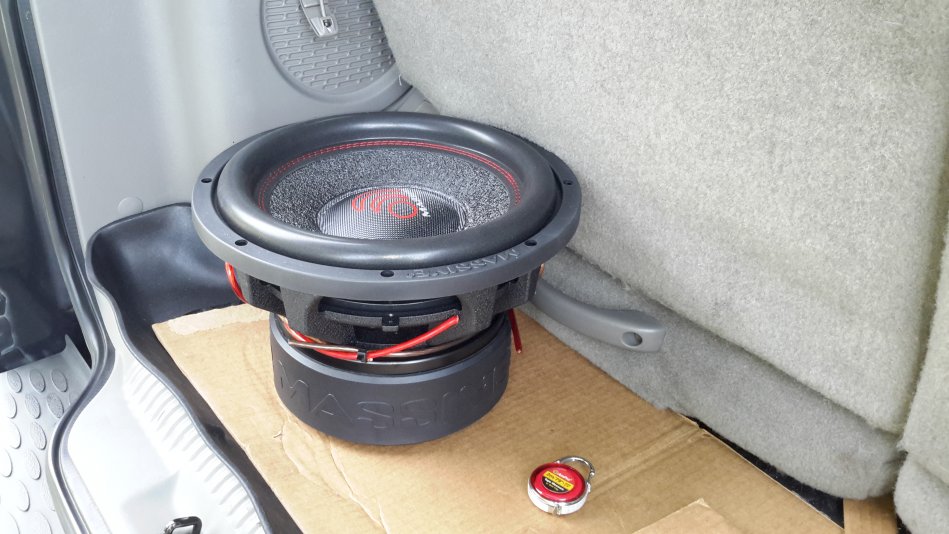

Now I just gotta figure out what the hell to do with this :hmmm2:

That looks awesome I really wanted to pick one up!
Is that one of them noise makers in the back? I think it needs to be mounted inside of a tube to work?

Nice job man!

Looks good....so no codes with the Envoy airbag.......gotta go find me one ;)

I got the wheel on ebay for $200. Got the airbag on ebay too. I coulda gone with the standard black gmc airbag but with a little research I took a chance. Ultimately, the airbag will be the only 'Denali' logo on the truck. As for the matchup, the airbag has the same part number from the root manufacturer. The only difference is delphi's front plastic cover. This is the reason for the difference in part numbers from gm. Youre looking for a 2 connector airbag. One tan and one pink.
