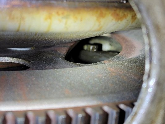

I don't blame you if you don't want to read this massive wall of text so here is the short version: Crank and knock sensors are not leaking at all. Oil cooler blockoff cover is not leaking. Like 99% sure now that it is a leaking rear cover/rear main seal. Several local quotes to replace the rear cover were all around $1,000 so I am going to drive it a bit to get a better idea of the oil consumption and go from there.
So I was finally able to pull myself together after the immense disappointment that it was still leaking after I replaced the oil pan gasket and get back under there to do some more maintenance and try to see if I could see anything new related to the oil leak.
As you guys suggested, I did take a closer look at both the knock sensor and crank position sensors behind the starter but both of those are unfortunately dry. I am still confident the oil cooler block off cover seal isn't leaking because its dry. I took the dust cover and transmission inspection covers off and stuck a borescope in the bellhousing and now I'm leaning much more towards this being a leaking rear cover seal/rear main seal. The flexplate itself appears dry, but everything else in there is pretty moist with grimy oily junk. I can just barely see the top of the rear cover through the holes in the flexplate and it does look wet way up in there. I called a few local auto and transmissions shops and the prices for a full rear cover replacement were $1,000 (local shop), $1,300 (local shop), $1,400 (AAMCO), and finally the hilariously high priced $2,000 local shop quote. Still waiting for one place to call back tomorrow, but I expect it to be in line with the others. I'm beginning to wonder why I spent all that money on engineering school when I could have been charging people $200/hour to work on their cars. Sheesh!
So at this point I think what I am going to do is take the camper out this weekend on a few hundred mile trip and get a better idea how much oil consumption there is going on. If it is less than about a quart per gas station stop, I guess I can deal with that due to the simple fact that it would take ~75k miles worth of driving to break even with buying oil versus having the rear main replaced. Kind of a gamble because if this engine and transmission somehow lasts longer than 300k miles (basically impossible that will be the case), then it would have been cheaper to just have the seal fixed versus topping up the oil every few hundred miles. But, if the engine or transmission gives up the ghost after a few trips pulling my heavy toy hauler, then I'm out ahead because I won't have spent $1,000 only to have to pull the transmission out a few thousand miles later anyways.
If it is taking closer to two or more quarts per gas station stop, then I'll have to get it fixed because that just won't be sustainable long-term.
I ordered a large metal drip tray from Amazon to help save my driveway in the meantime.

If it looks like the rear main leaking, but the rear main is good, then it's probably the cover gasket. The rear main seals to the rear cover, and the rear cover has a gasket to the block. There are two oil galleries at the top that are connected and sealed by this gasket, and the rear cover acts as part of the channel.
I had a really bad leak that was coming from the back, but above the oil pan and not the rear main. L59 engine. They replaced the rear main while they were there, but the cover gasket had cooked by the heat and failed at approximately 287,000 and 8500 engine hours.
Not sure that this is the right part for your engine, but check P/N 1263 9250

I think we are both on the exact same page because I don't really see oil wetting around the rear main seal itself. Just general oiliness around the periphery of the rear cover but its pretty hard to see through the transmission inspection hole. All of the shops I called said they replace the rear cover when they do a rear main seal because they get it all as a kit like that so, if I decide to move ahead with the $1k repair on a truck that only cost me $6k, that should fix the leak. I took my camper on a 100 mile drive up in the mountains today and the truck did so much better than I was expecting that I am a little more inclined to get it fixed whereas before, I wasn't sure the truck was up to the task of pulling my relatively heavy toy hauler.

The very first thing I tried was fluorescent dye in the oil. Let it run a few minutes while I watched with a UV light anddd nothing. Check it again the next morning and the entire rear of the engine was glowing like a rave club. So, that was less helpful than desired.
I think you have a good point about the rear main though. There is a lot of air movement and centripetal force in there to fling oil away from the center that could be making it appear dry. I think a rear main and maybe the new part number rear block cover might be the next move. I still need to see if it's possible to do this at home but just from looking under the truck, that seems like a pretty big task to do in the driveway so I'll be calling some local shops for quotes.
Anyone know what a "fair" price range would be for a rear main replacement on one of these? I'm thinking ~$1k which really sucks.
