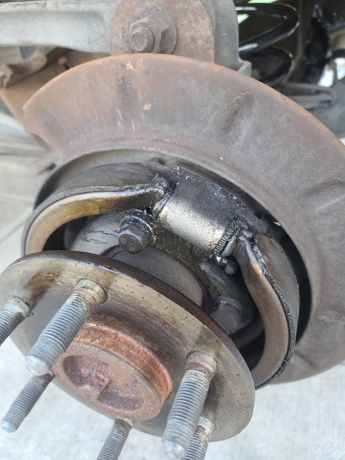

I have 220000 miles it is a 4wd I replaced the cv axle on passenger side and upper ball joint and hub assembly on the drive side. I just lowered it. It it was already making the noise.

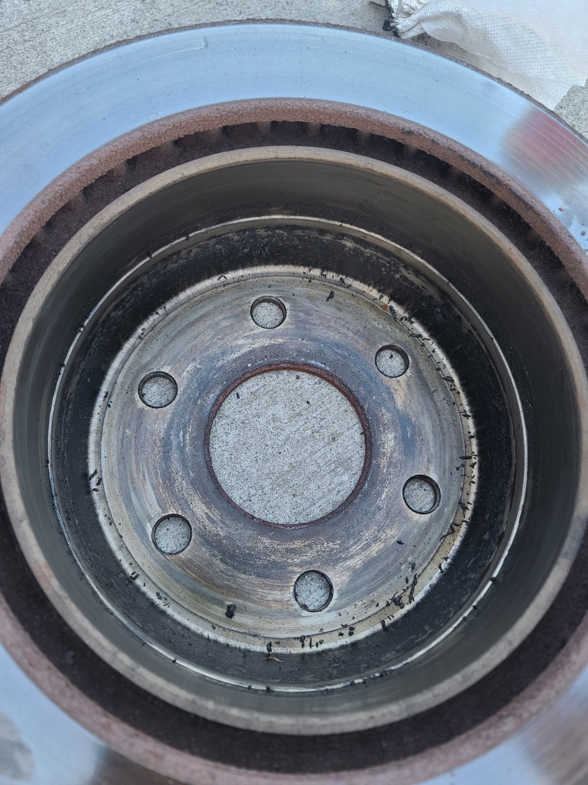

so it was making this noise prior to being lowered. makes a grinding noise when turning and around the time a bump is hit it makes a grinding noise for a bit then stops again. first thing i would suggest is checking your brakes along with the dust shields. those dust shields are pretty thin and can flex a bit under normal operation. ntm how thin they are a grinding noise is like a tuning fork off them and makes it sound 100x worse than it is.
