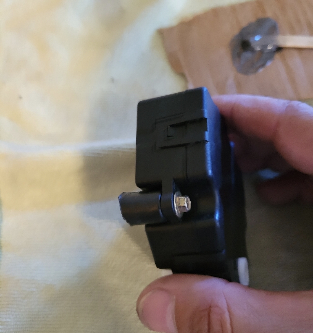

I bought this awesome piece of nightmares back in March. Knowing that the heater and AC did not work. In the winter I worked on the heater. Figured out every blend door actuator was broken. I disconnected the wires and removed all actuators but the recirculating one (the hardest one), stuck a screw driver in the climate control mode door to keep it open so I'd have heat.

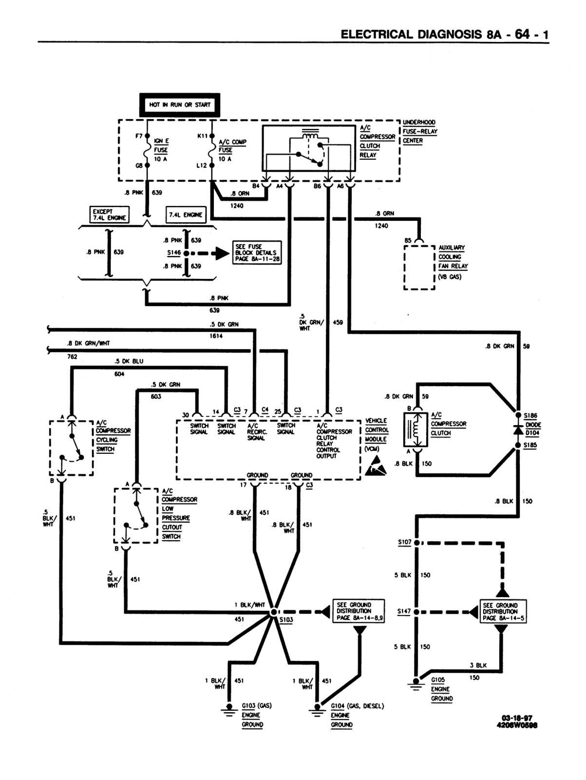

Now it's summer and naturally I want AC. So I start plucking away. Absolutely no freon in the system. Checked all fuses, was good there. Next I checked the compressor by jumping the relay, that worked. Today. I'm checking pressure switches.

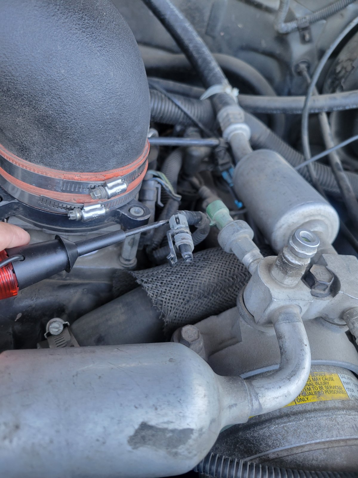

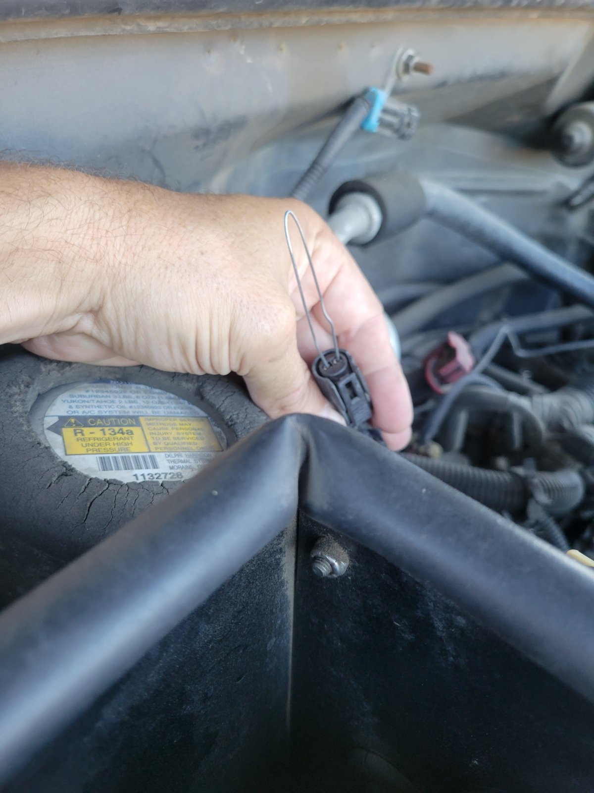

Swapped out the AC relay for the Horn Relay. Started it up, hit the AC button on the dash, and turned the blower on full. Pull the wire off the condenser jumped it and nothing, pulled wires off of compressor and same. Grabbed my test light. No juice to either.
I do have juice to AC compressor relay switch though and to the ac fuses inside.

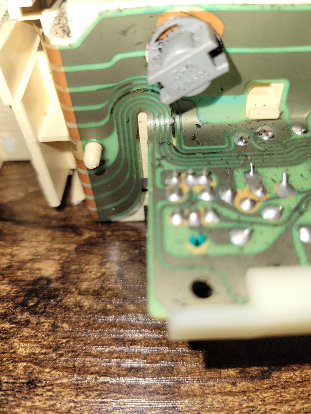

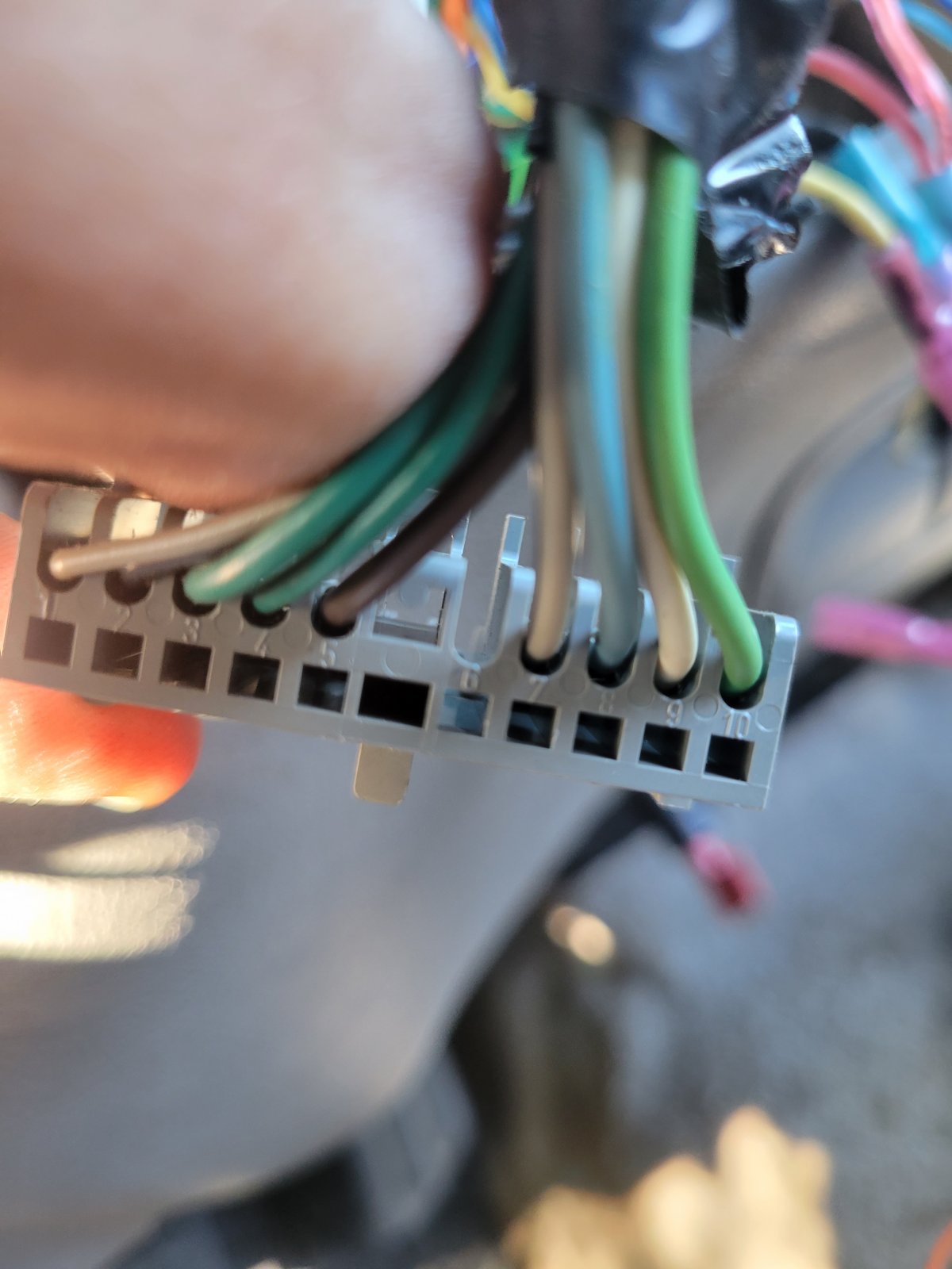

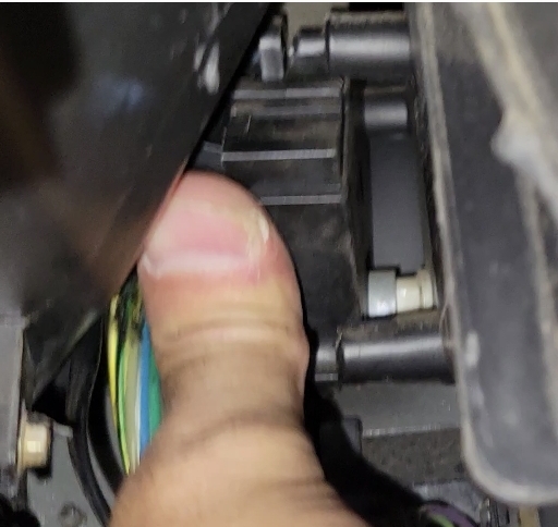

Okay, happy to see this! Control module circuit board has a burn on it. Looks like it's on the #5 wire which is brown and that's the only wire that has power to it. I read on another thread that the light green wire should have power with fan on and ac on and mine does not. I'm going to try and jump it tomorrow.20230818_170903.jpg20230818_163026.jpg
