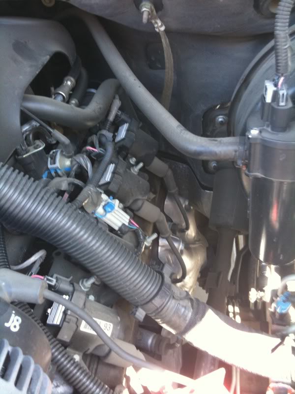

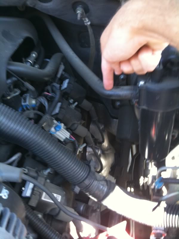

The best way is:
-park outside
-get a very small funnel
-find your brake booster (big round black part attached to the firewall driverside)
-pull the rubber hose off the brake booster (should be a compression clip, use big plyers)
-insert your funnel into the hose
-start the truck
-take note of the suction coming from your funnel
-open can of seafoam
-put your thumb on the can and slowly pour it down the funnel
-take note of the changing idle
-keep pouring, slowly increasing the amount and use half the can
-truck might stall
-(running or not) install the brake booster line back on the booster
-truck might stall
-if not stalled, turn it off
-wait 20-30mins
-start truck
-drive like you stole it
Whoala.

Do what you want, I put mine in the oil.
I did the above twice now this weekend, thick smoke each time...loved that it was doing something :)
I'm sold on the stuff, check my threads

I did mine yesterday, I used a smaller hose and installed it into the brake booster hose and used it to suck the fluid out of the can while my wife sat in the truck and kept the truck from dying (I had half a cans worth of seafoam in the can so I didn't suck out too much!!). That was the only thing different than what Boss did!! I basically did that with half a can, poured another half a can in the oil and poured 1/2 a can in the gas, my truck always drives better after I do all of that!! For those keeping track, I bought 2 cans!!:rofl:
Talk about a white smoke screen, I went over to my neighbors house and advised them to close their front door and windows and I'm glad I did, I couldn't see thier house for the first minute of revving the motor!! ha ha ha!
