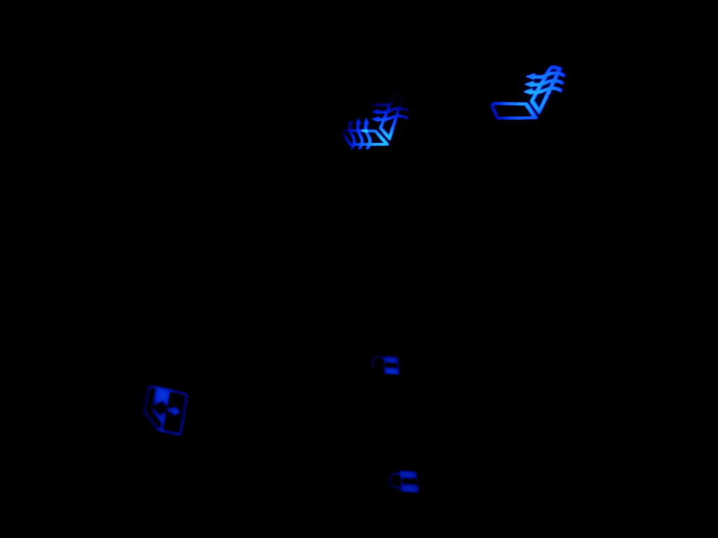

has anyone else done a led interior switch and instrument cluster conversion?
adrst2.3
May 30, 2013
Hey guys i wanted to know if anyone ever attempted to do this.
let me know what you think.

Some of the LEDs look brighter than others. Is there a way to avoid that?

Depends on where you put the actual LED and what kind of viewing angle the LED has. So there can be "hot spots".
^^ this , 9/10 its the Beam angle that decides how bad the hot spots become

cam exposure also effects how the lighting is shown when you take a pic.when i snapped these photos i tried turning the exposure down.i used smds on everything shown.
i know i had to redo the main window switch do to the fact that the distributer(ebay seller) i get my smds from sent me lighter shades of blue mixed with actual blue.boy did that annoy the hell out of me.at that point i had to test each smd before i installed it in a switch you know how hard that is?...ahhhhhh
by the time i was done i didnt want to see another led in my life!.lol
