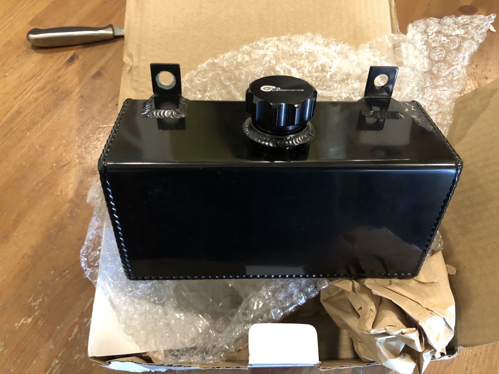

I looked at my engine bay, looked at options, and decided the On3 reservoir made sense for me. It fits in my limited space, it’s not ugly, and it includes a pump. At first I thought $75 was a bit much but that’s about what a new OEM plastic one with pump would cost. It’s ordered. Thanks for helping me spend money @Dantheman1540. It will be nice to have washer fluid.:D

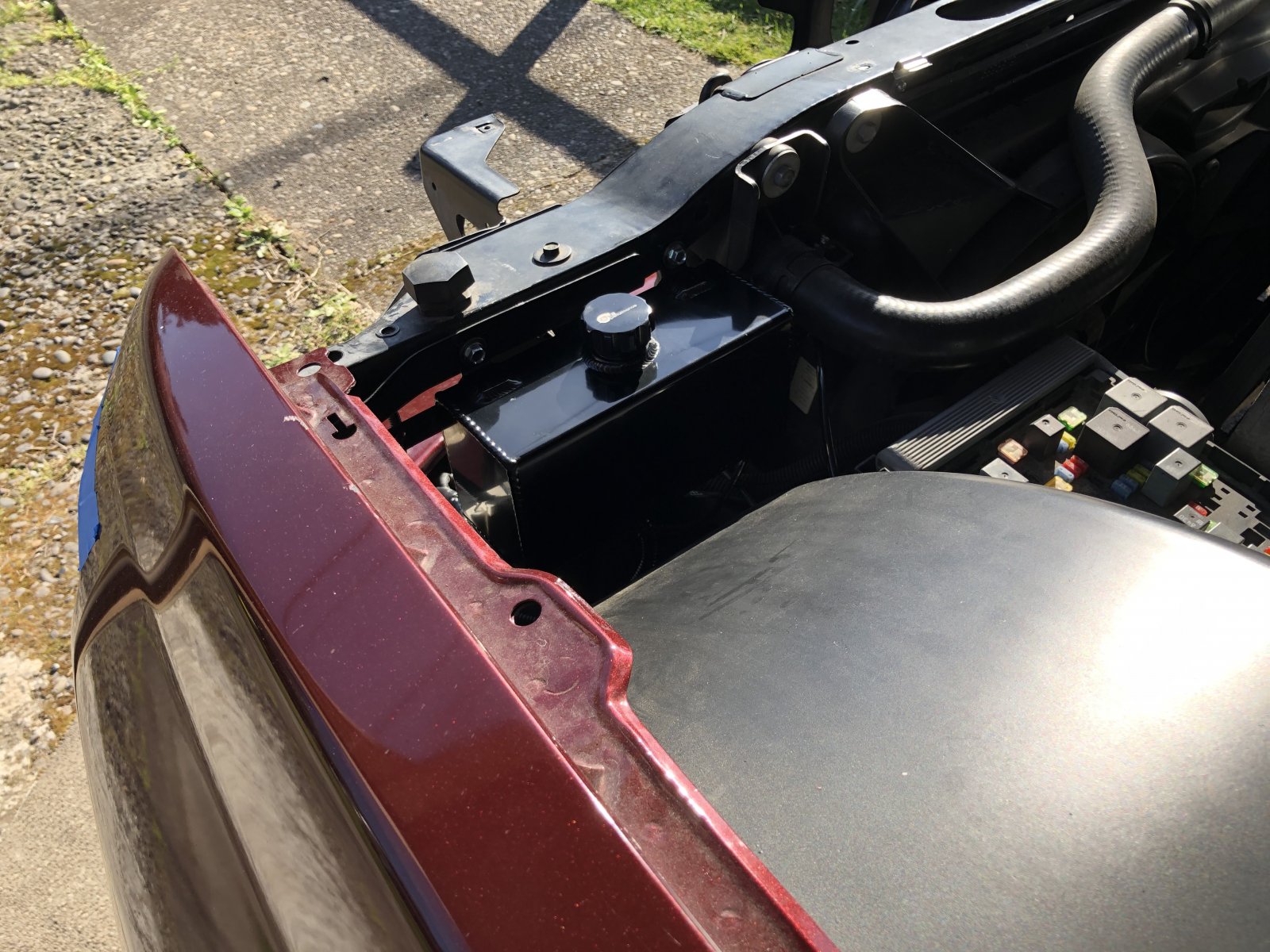

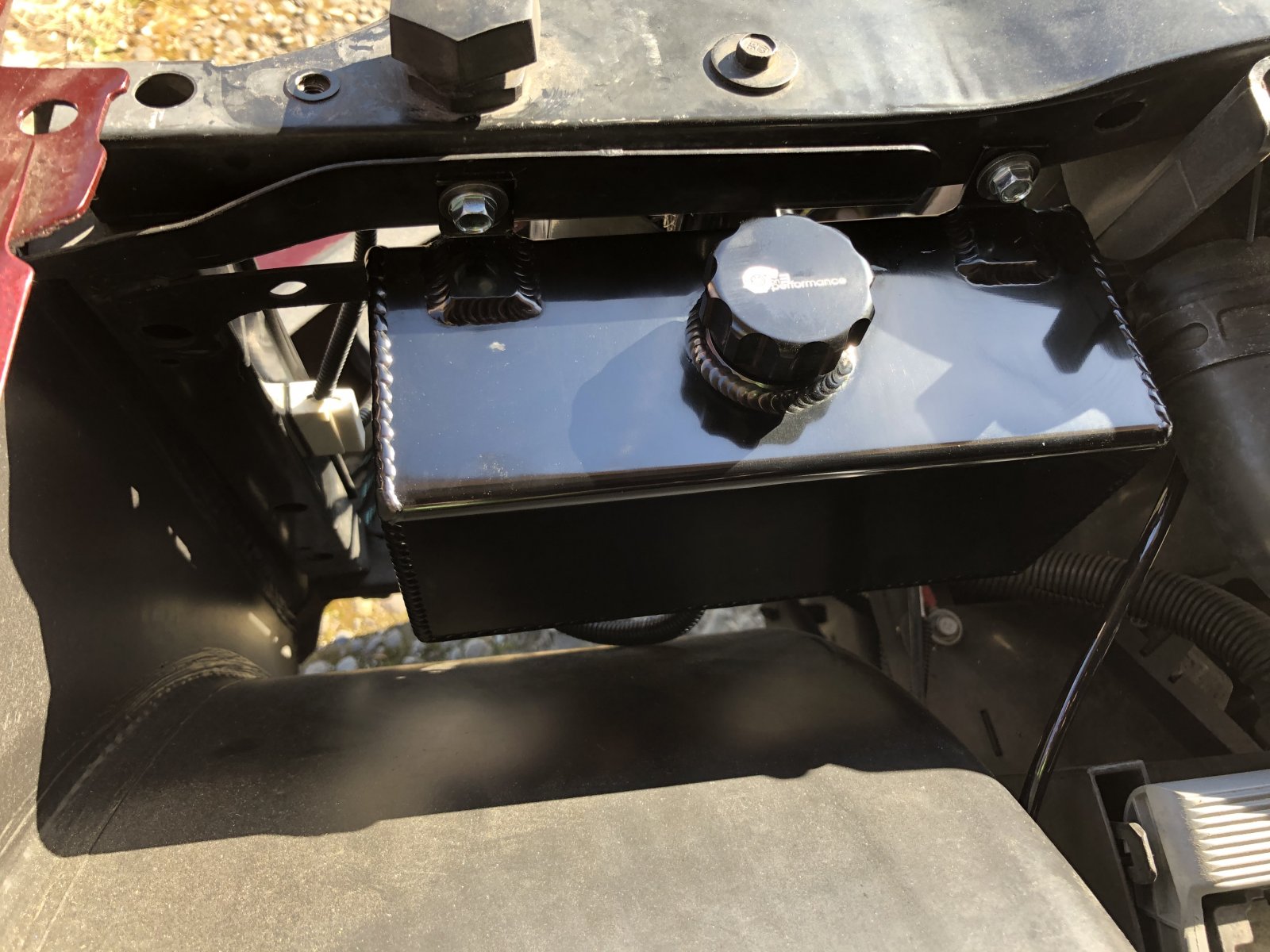

I’m putting it to the left of the radiator but the engine bay on my Silverado has tubs that take up a lot of room. The fuse box, battery, and coolant overflow tank are all relocated.
