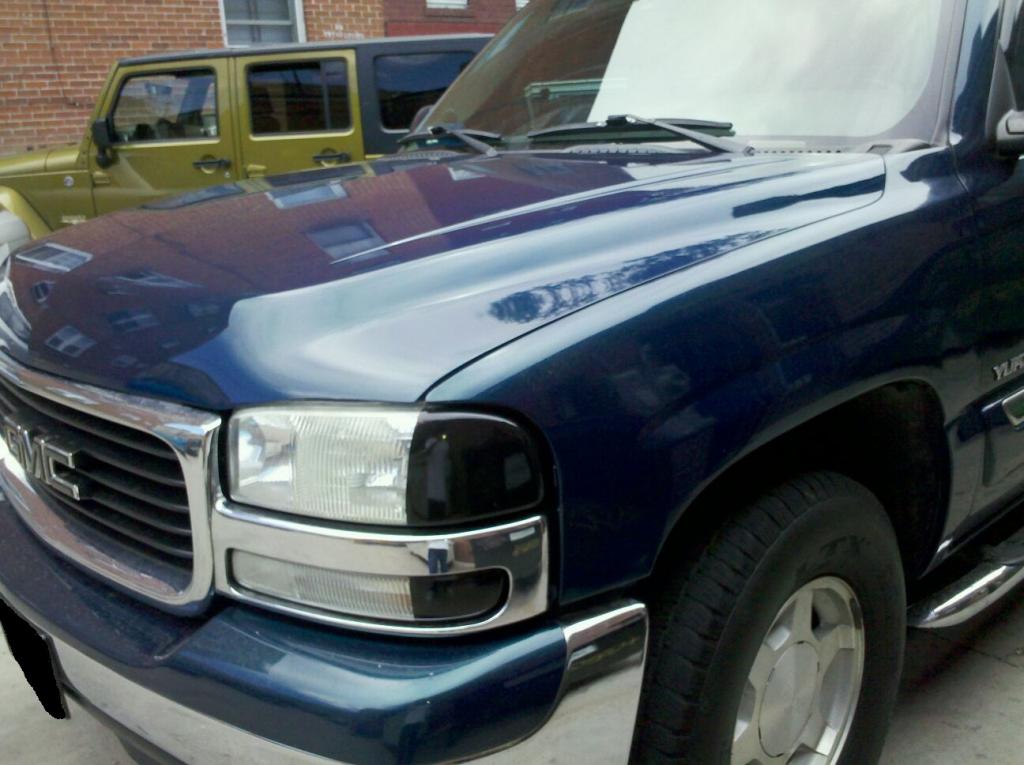

Hi new on here and just thought I'd share my experience with the HD hood. It bolts right up to your stock hinges. You just have to cut around the headlights so you can close it. Another thing is it doesn't cover the grill completely so you might want to make the holes on the hinges a little bigger to pull the hood forward

im curious about the "hood not covering the grill" this is where some pics would be really great!

Here's a pic so you can see what i mean by it doesn't completely cover the grill. It was popped out a little but it gives you an idea.
