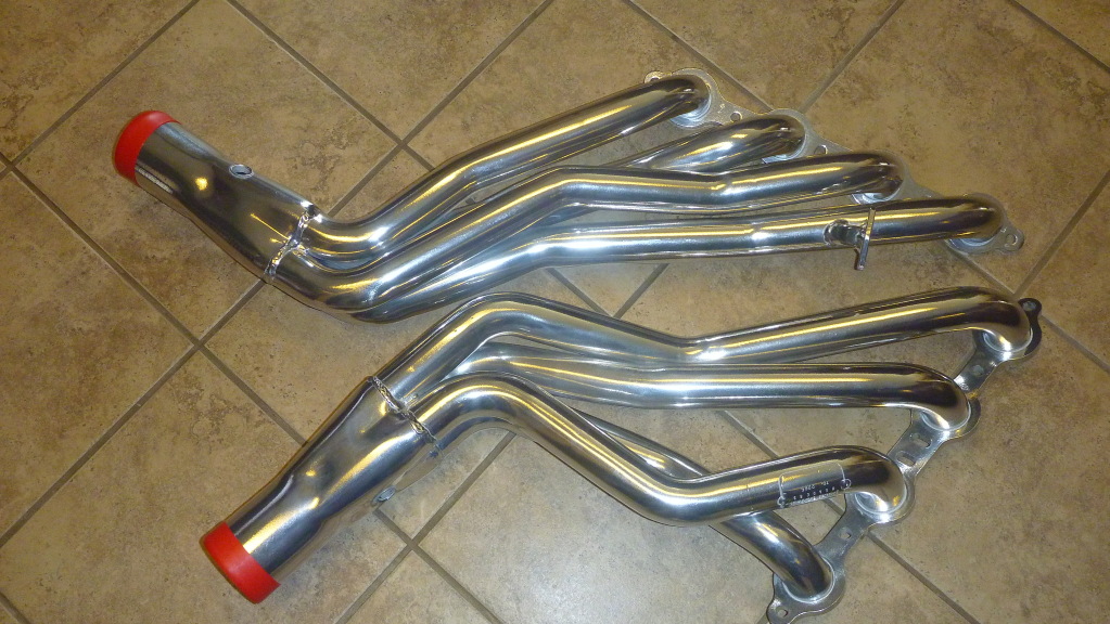

I received my Pacesetter Headers & y-pipe last week. I am going to install tomorrow. It came with gaskets but, after doing a little research I went out and picked up some new OEM gaskets and Stage 8 header bolts. Also going to swap out the sparkplugs while I'm there.
Anyways I currently have the Tahoe programmed with a Hypertech programmer. Should I return to stock before doing the install? Yes I plan to get a real tune but waiting till I get my electric fans first. I Know I should expect the check engine light due to the rear 02's being dismissed. I'm not sure if I will be able to use the programmer at all after the install. Does anyone know if the programmer will be completely obsolete? or can I still use in the meantime?
